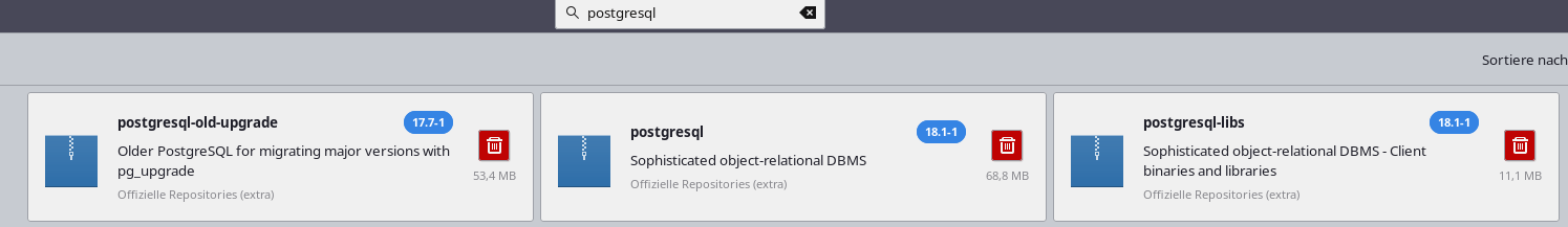

UPdated the three packages:
$ pamac checkupdates
   3 Aktualisierungen verfügbar:
      postgresql              17.5-5 -> 18.1-1  extra
      postgresql-libs         17.5-5 -> 18.1-1  extra
      postgresql-old-upgrade  16.9-2 -> 17.7-1  extra
$ pamac update
