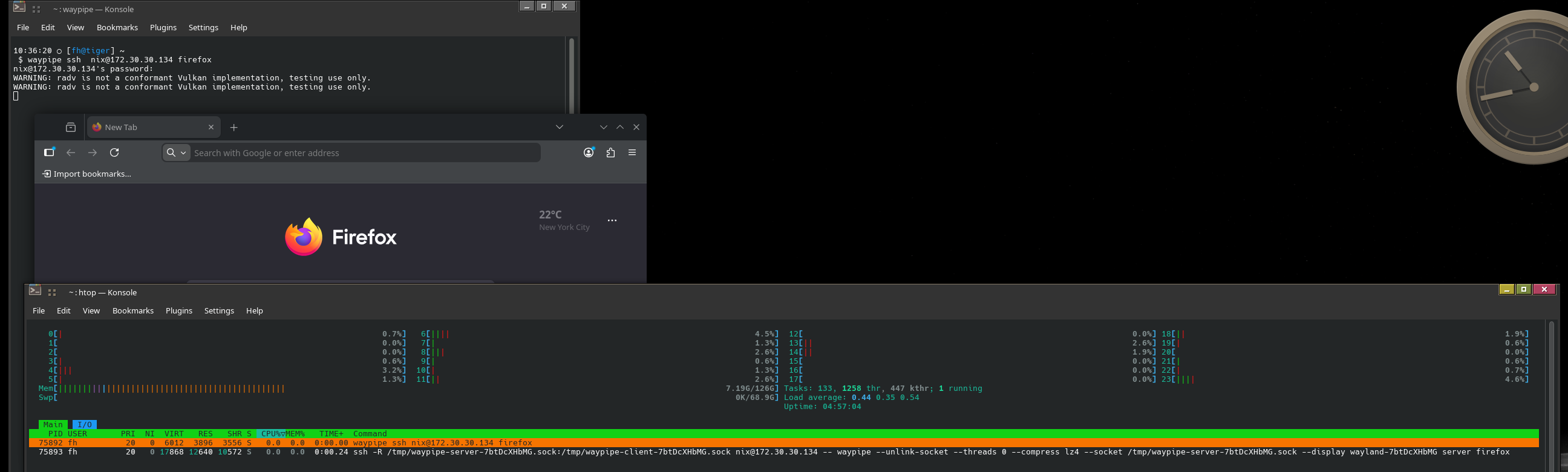

Screenshot
The firefox browser is running over waypip

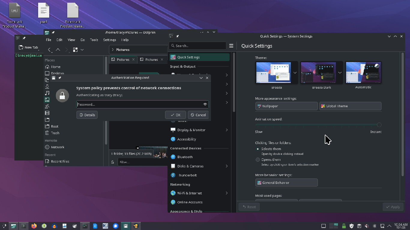

I am actually posting this from my media machine, while sitting at my daily driver laptop, while also running an update via pamac-manager on the media machine.
By happenstance, because I don’t use a bottom panel on my daily driver, but I do on the media machine. The bottom panel from the medi machine does not interfere with the panels on my daily driver.

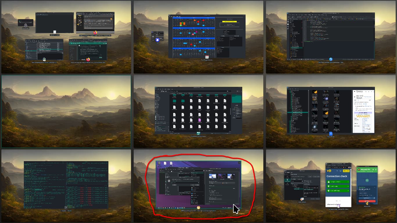

Here is the remote Desktop running on my daily driver
The Remote Desktop is actually running in it’s own Wayland Window, as if I was running some RDP app.
