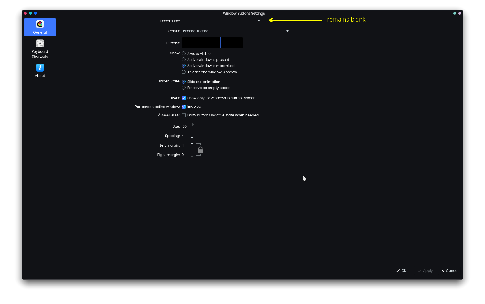

It only works with the Breeze window decorations, and it ignores — as in “doesn’t even save” — any other setting.

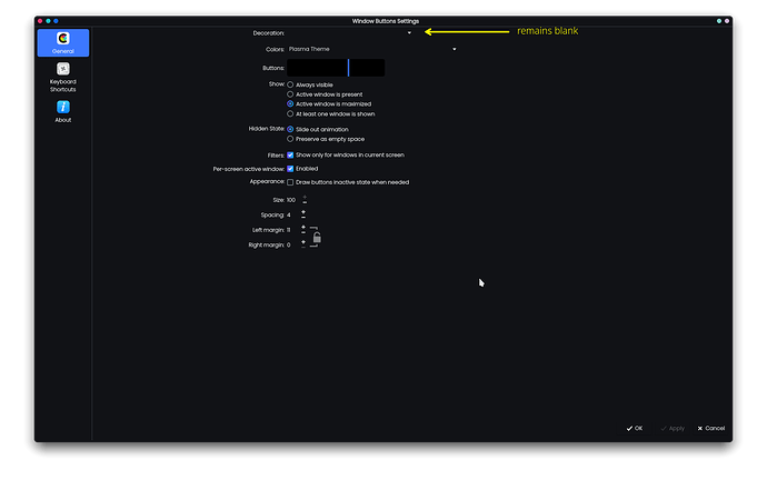

When checking the settings by right-clicking the blank applet, you get this… :backhand_index_pointing_down:
When changing the setting to how it’s supposed to be (and how it was before), the Apply button becomes unavailable. :backhand_index_pointing_down:
Furthermore, closing the applet settings — whether you’ve changed anything or not — triggers a plasmashell restart.
