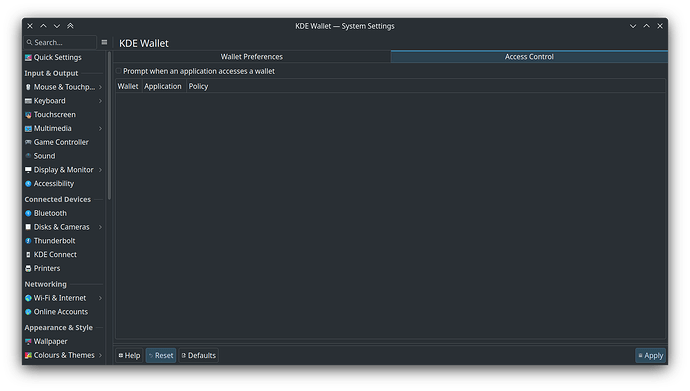

this is what my wallet gui looks like atm

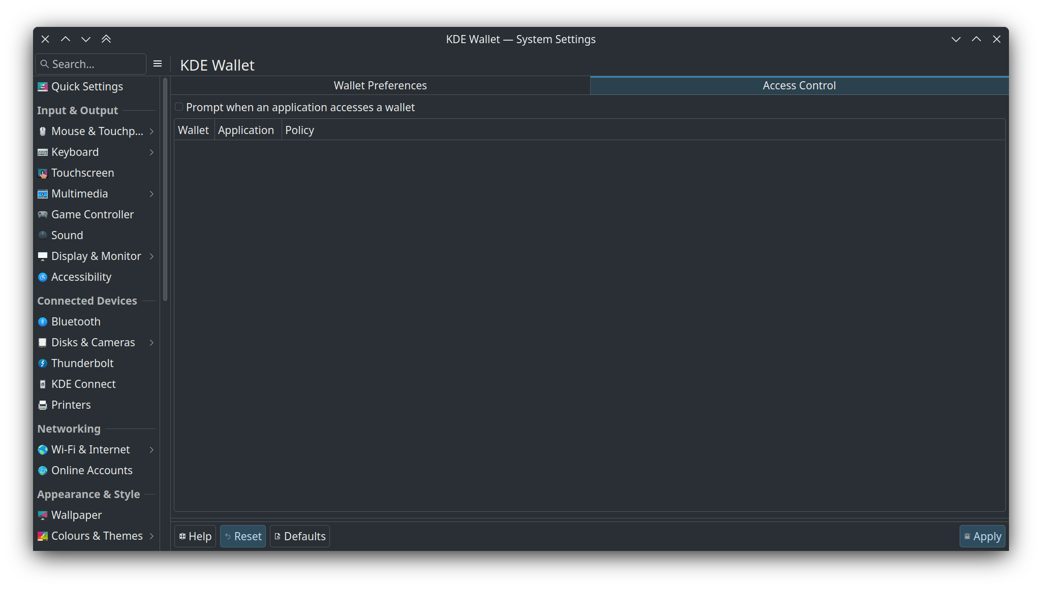

I have no default (or any) wallets listed in the “Default wallet” pull-down for me to set it back to my default wallet. Also the "Launch wallet manager button has gone from the bottom.
Also there are none of my wallets listed in the access control.
I tried making a new wallet, it did allow me to do that but it never showed in the GUI , it is still blank.
But, at least i have access to my NAS back again. I do use the wallet for other things though and will need access to it at some point.
o cool, its added a wallet manager to the tray i just noticed. Dont help me though , still opens blank

re your screenshot of “wallet preferences”:
under “Default wallet” nothing is selected
For me it shows: “kdewallet”.
But I have never used it and nothing is in there - mine is a pristine default installation.
He says the menu is empty. :point_down:
