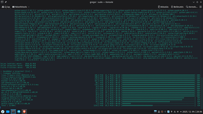

but the full system update still hasn’t happened.sudo pacman -Syyu  :check_mark:
[sudo] gregor password:
:: Synchronizing package databases…
core 146.3 KiB 1016 KiB/s 00:00 [## [Y/n] i
:: Replace vulkan-mesa-device-select with: extra/vulkan-mesa-implicit-layers? [Y/n] i
resolving dependencies…
checking for conflicting packages…
error: failed to prepare transaction (failed to satisfy dependencies)
:: installing aprotobuf (33.1-1) breaks dependency ‘libprotobuf.so=32.0.0-64’ which is required by libopenshot
Remove libopenshot, which is an AUR package, update your system and recompile libopenshot against the new system …
