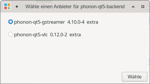

Hello @cscs
If you install digikam or okular the message appears:
:: There are 2 providers available for phonon-qt5-backend:
:: Repository extra
  1. phonon-qt5-gstreamer 2) phonon-qt5-vlc
    grafik
That’s where my question came from.
Yes, phonon-qt5-vlc is younger, and I will use this one from now on.
Normally that is wise, however in this case the two options are alphabetical so the GStreamer option is first. Arch hasn’t addressed this yet and I’m not sure what the best way to present it to them is. The wiki mentions KDE recommends the VLC option, so at least there’s that.
