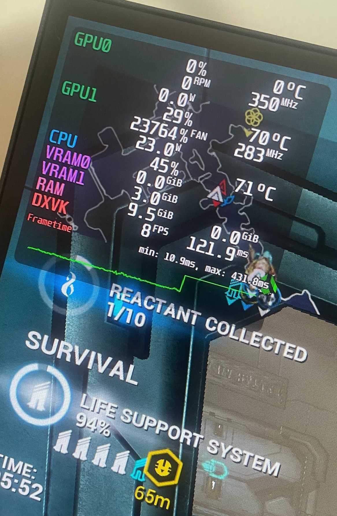

Periodic FPS drops when playing on Steam
[Hello, when playing steam games, I get stable fps then it drops frequently to 7-17fps. Issue happens only when playing games via steam.
Sometimes I also play games via rpcs3 and there are no issues.
Thanks for the help.

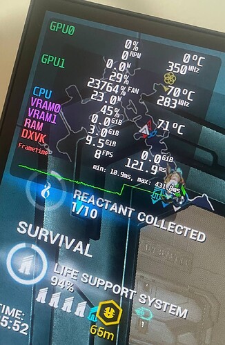

Hi!
You might want to use the “pre-formatted text” feature for posting system info. :wink:
But good to know I’m not the only one. I think it might have something to do with the shaders being loaded for nearing need. This is just a pure hunch, nothing solid. Hopefully someone has more insight.
Thanks for the info!
Maybe it has to do something with the fact that a laptop has 2 GPU’s. That could cause some interference.
But that does not seem to be your case, because from your profile info I can see that you have a desktop CPU.
Hopefully someone will know the answer.

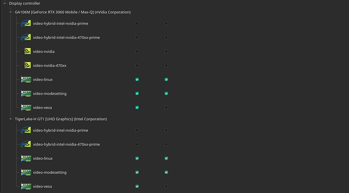

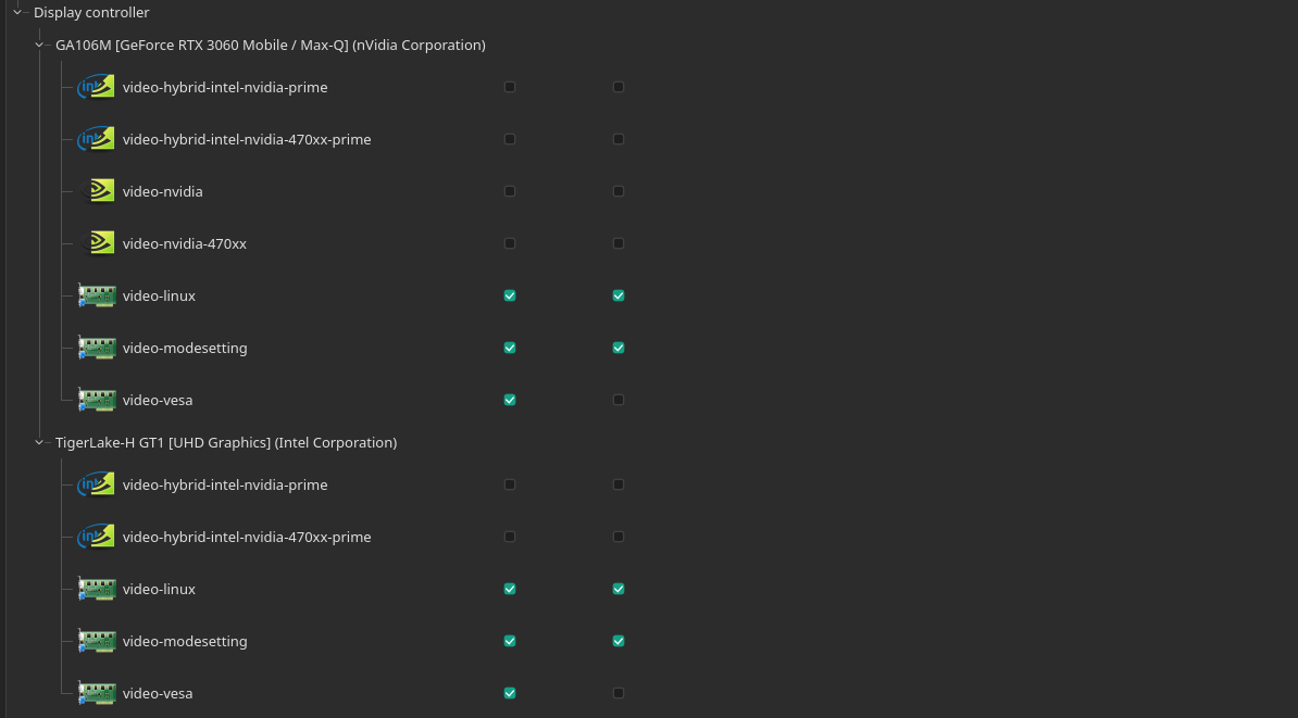

You don’t have NVIDIA drivers installed so you may look into that.
Once Nvidia is installed as hybrid video card, you can configure the games in Steam to enforce using NVIDIA card for your game so you don’t use the integrated unsupported Intel chipset in Steam.
Also you say it “works here” and “it doesn’t work there” basically, but it seems you do two completely unrelated comparison (are you? do you test the same game?)
I was just trying to clarify that this problem applies to all the steam games, that I have launched.
I was checking the drivers with manjaro setting earlier via img.
I just tried installing drivers. Will test later today and post if it works better.
Don’t install random stuff. You’ll probably need video-hybrid-intel-nvidia-prime driver. This should allow to be able to work with NVIDIA on demand in Steam for example (rest of the time it should use Intel). in terminal command should be sudo mhwd -i pci video-hybrid-intel-nvidia-prime
Someone with this kind of setup will add more info about how to launch your Steam games with NVIDIA afterward but first thing to do when you have installed the driver and rebooted, post the inxi -zv8 output here again to verify drivers are now OK for NVIDIA.
Nouveau is a “Yay! It sucks but we finally have an open source driver!” kind of driver for Nvidia cards. It lags A LOT behind the proprietary driver. Even a typical guess of fps drop or stuttering which is the lack of VRAM might not apply since that driver is so bad. So yeah, go proprietary and change your launch option to:

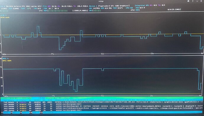

prime-run %command%
to make it run on the dGPU. Unfortunately, Steam cannot apply this globally so you have to do it for each game. At least if you install the official Steam package instead of the Flatpak version.

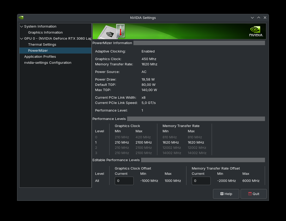

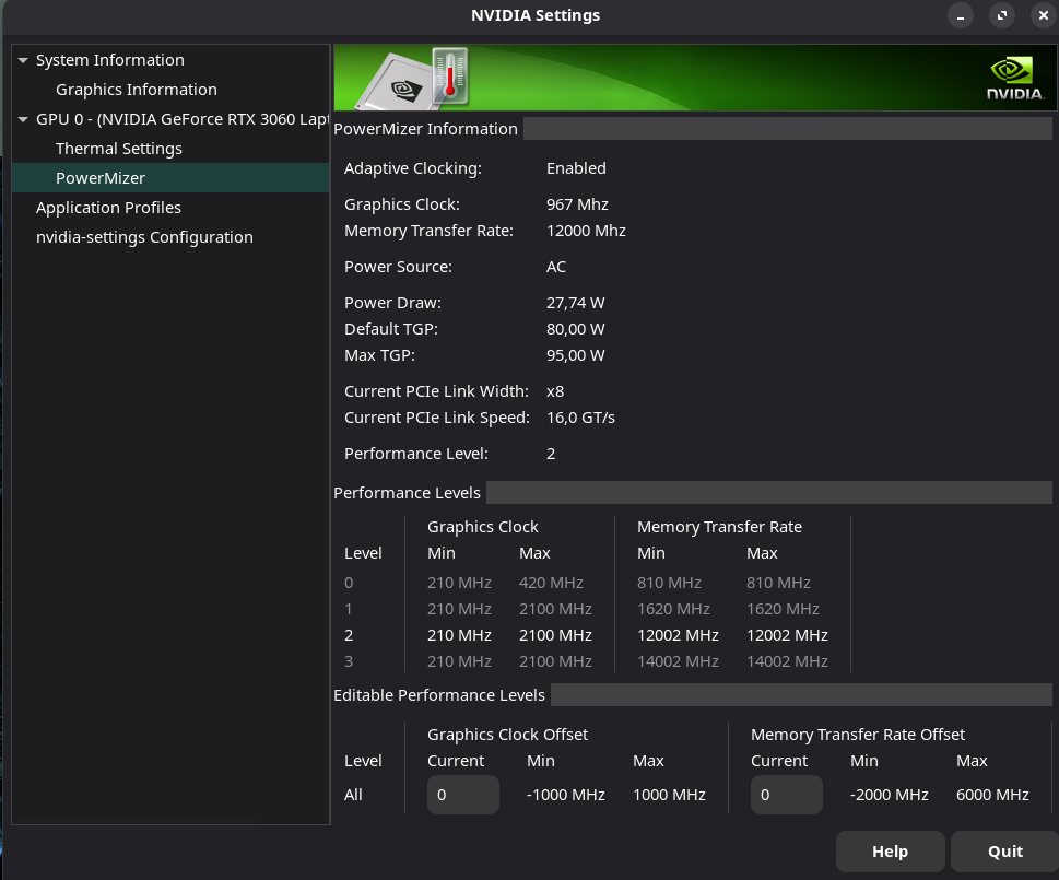

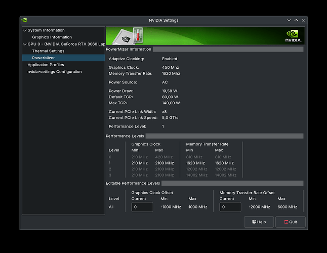

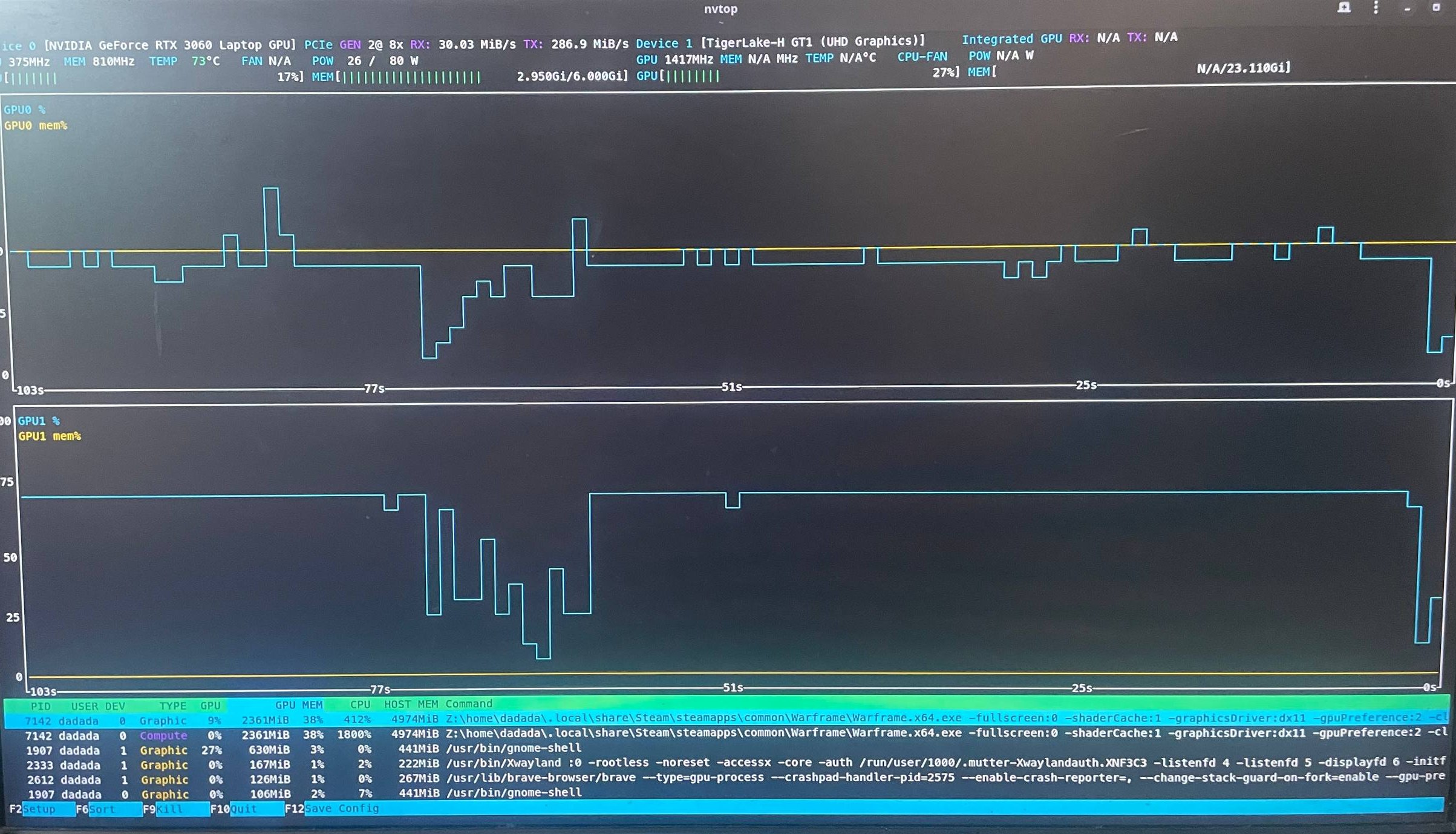

After installing and restarting this is the output.
The issue still remains after launching the game with
prime-run %command%
Thanks

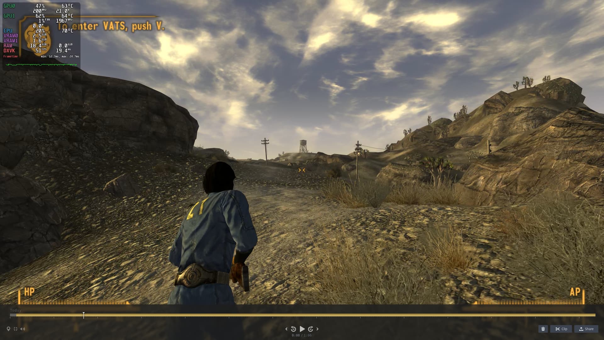

The same issue happens, when I play Fallout NV. It should not be linked to resources IMO
It seems it is properly installed now.
What is the output of both commands vkcube and prime-run vkcube
Indeed that game is low on resource demand. But let’s find the bottleneck: install mangohud and change your launch options like so:
mangohud prime-run %command%
run the game and watch once frame time raises uncomfortably, which resource is maxed out.
We have similar systems, only mine comes with Ryzen 7 6800H and I have 32GB of RAM, shouldn’t matter much but let me try that game as well.
EDIT:
Got stable 70-72 fps on Ultra High Quality at 1440p, even outdoors. So I think we really need to find out what is bottlenecking your system through mangohud.

CPU usage about 30% when playing Warframe.
Cannot see the GPU in mangohud tho.
When FPS frops the only affected status shown is MS, that raised to 70-170ms

So this is how mangohud and cli looked when I got the FPS crash.
None of the resources look to me maxed out.
Frametime ms got up to 700ms
It is weird, that mangohud displays different stats then the cli tool

@omano I’ve attached mangohud stats as a img to this reply.
From your screenshots, I have several suspects. From the low frequency to the low power usage. Can you retry and and monitor those two and see their value before and after the stuttering? I’m afraid we have power delivery issue here, i.e. the VRM is not capable of delivering high power for a long period of time.
Compare that 283MHz to this almost 2GHz (the fps is lower than my claim above because I’m screen recording):
Also, open nvidia settings and screenshot this page :

It doesn’t seem to use the Nvidia card, are you sure you start the game with proper launch options in Steam?

OK guys, for some reason the game doesn´t drop fps as it used to.
Launch options: gamemoderun mangohud prime-run %command%
Driver: driver: nvidia v: 575.64.05
Thanks for the help!
But I have lower fps. I’ve used to have ±160 now I have 30-80±
But after a while of playing I get 120 and higher mhz
And after 1 mission I am back to 165FPS. Interesting :thinking:
@leledumbo
When I launch a game it usually goes to 2-3. When not playing a game the level is 0.
