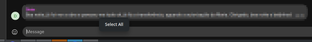

  1. the contextual menu from right click is almost empty. I should have made a print screen. I’ll do it next time it happens.

Hello! here’s a print-screen of the right-click menu. As you may notice, the paste option is not listed.
The text string IS in the clipboard.
I also successfully tried to copy from Signal to paste it elsewhere. After having done that, I tried to paste in Signal again, from Firefox, and the paste option had reappeared.
It seems that for some reason, Signal is not always informed or able to detect the content of the clipboard.
