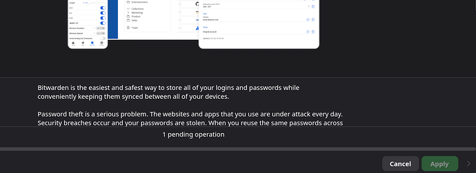

I have a little bit of a … strange one .. and I don’t really know how to troubleshoot.
The “Add/Remove Software” (pamac i guess) is stuck at “pending operation” (see below, trying to install Bitwarden)
I have looked around, and some old reddit post looking similar says to “sudo pacman -Syyu”. I have with no error messages.
Thoughts?
Thank you for any help.
If you are doing it on command line with sudo pacman -Sy bitwarden, what happens?
It should do something and put some info on the screen.
Finally you can find the pacman.log in /var/log
you can review the last lines with sudo tail /var/log/pacman.log
A pending operation can also be caused by a still running pamac process in the background.
For the sake of reproducing - I just tested with the Pamac GUI - no issues.
I am thinking an issue with the mirror perhaps caused by intermittent network errors.
Try change the primary mirror - you can use Pamac - try the Global option.

I got one step further it seems with updated the mirrors. Pamac is not stuck at checking dependencies…
Another strange thing… I cannot open “Preferences” in Pamac… it just… hangs…
