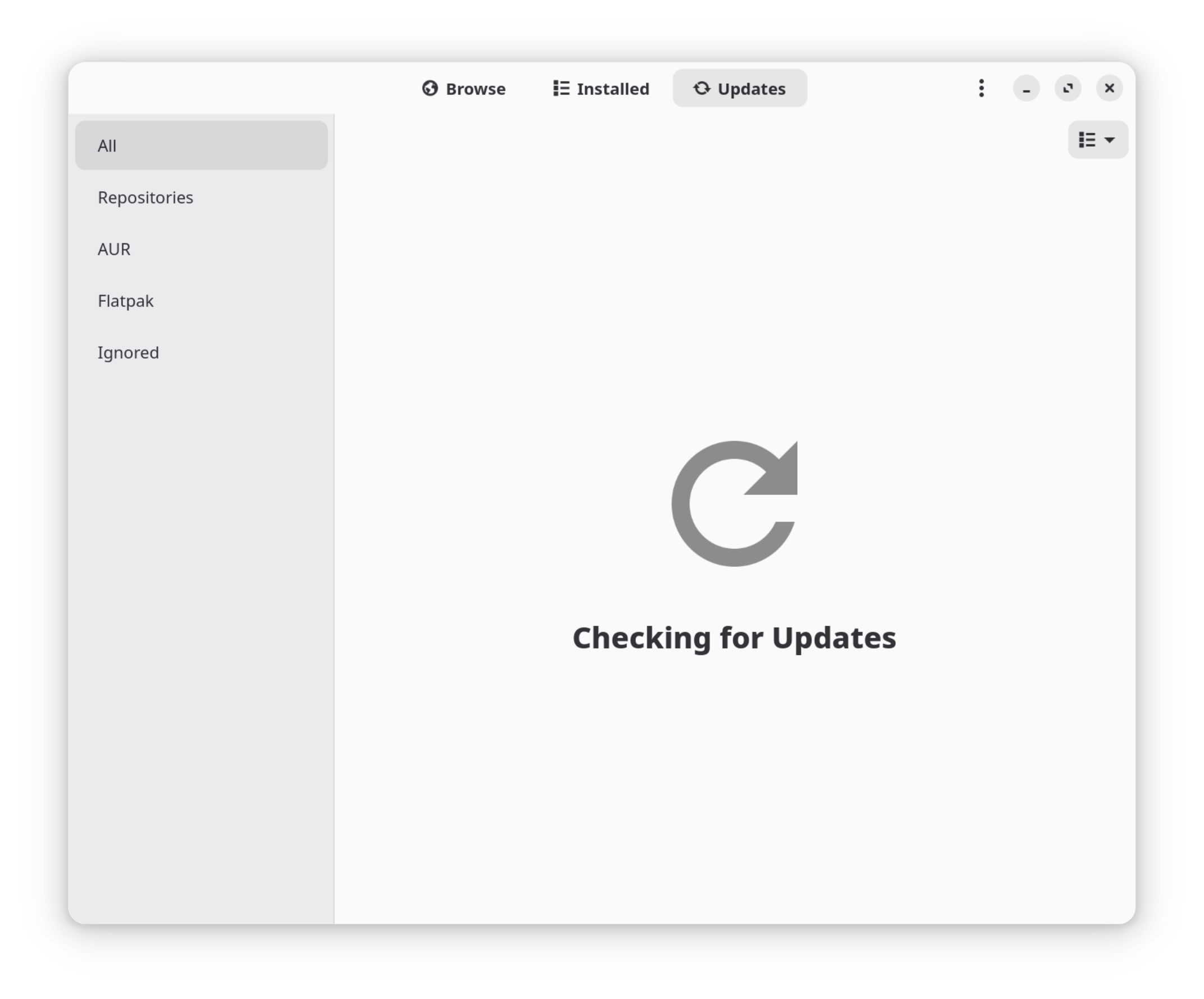

I found today that I’m unable to check for updates using the GUI. Using pamac in the terminal works fine, but the GUI is stuck at this screen:
type in the terminal: checkupdates enter
That command appears to run successfully (no errors shown anyway), but it still doesn’t fix the mentioned issue.
