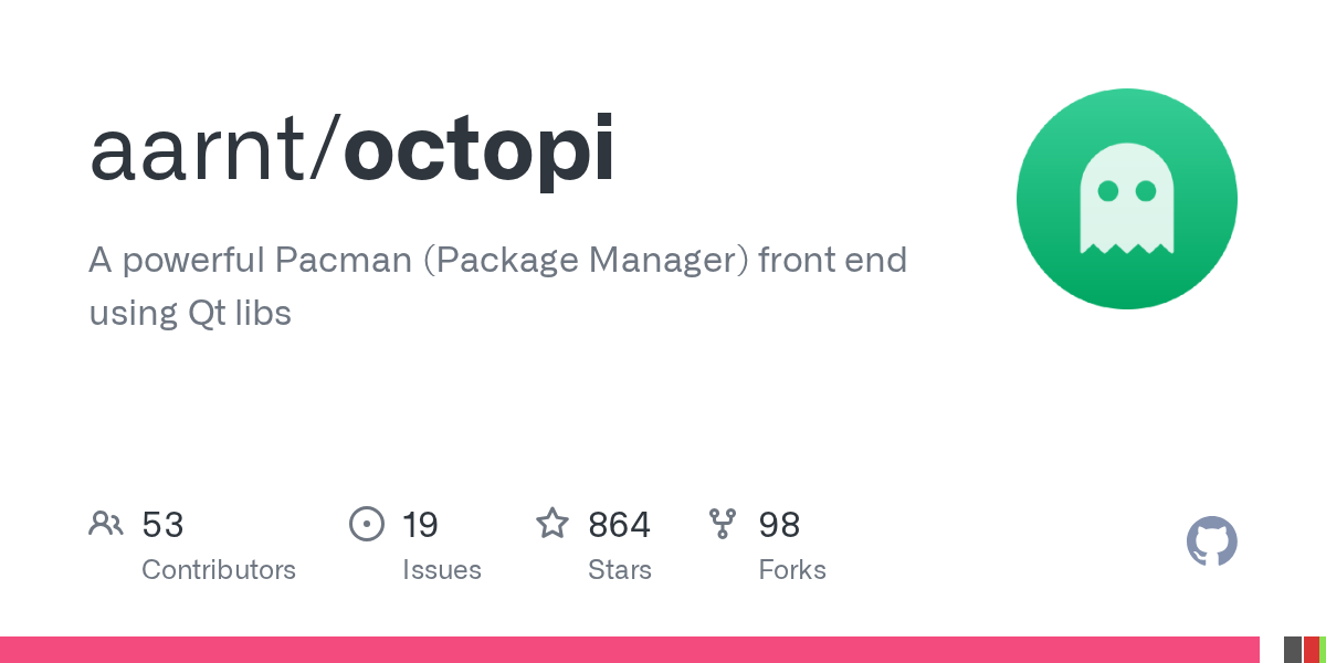

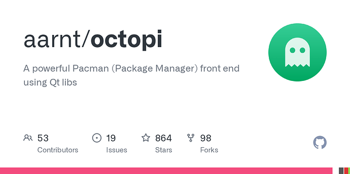

For those who must use a GUI package manager, it has been suggested to use octopi instead, to replace pamac-manager (Add/Remove Software).
sudo pacman -S octopi
