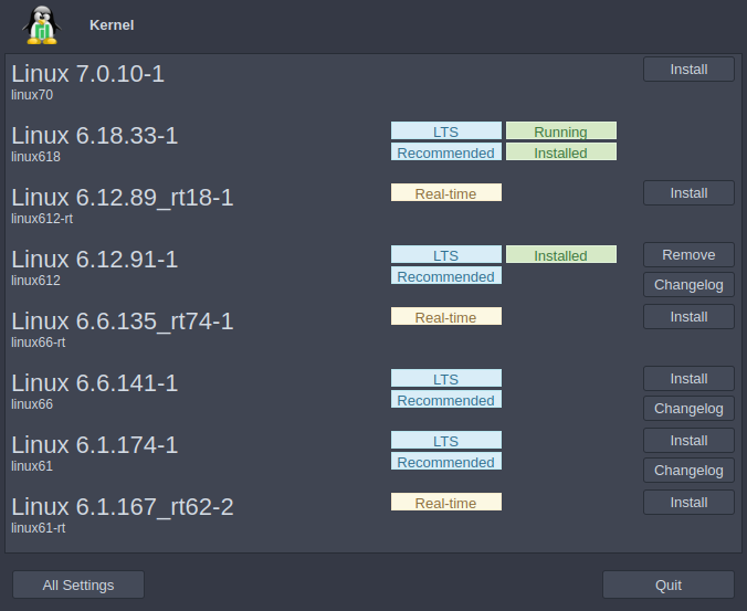

Manjaro Settings Manager shows four Recommended kernels
but users are usually recommended to install two kernels

@lagagnon
According to you;
Was this information not accurate?
If kernel 6.6 works better than kernel 6.1, it would be prudent to remove kernel 6.1
and install another LTS kernel (6.12 or 6.18) as a backup kernel.
If the current kernel has issues in the future system can be booted with the backup kernel
Every LTS kernel is recommended. But the newer LTS ones are… even more recommended :grinning_face_with_smiling_eyes:
