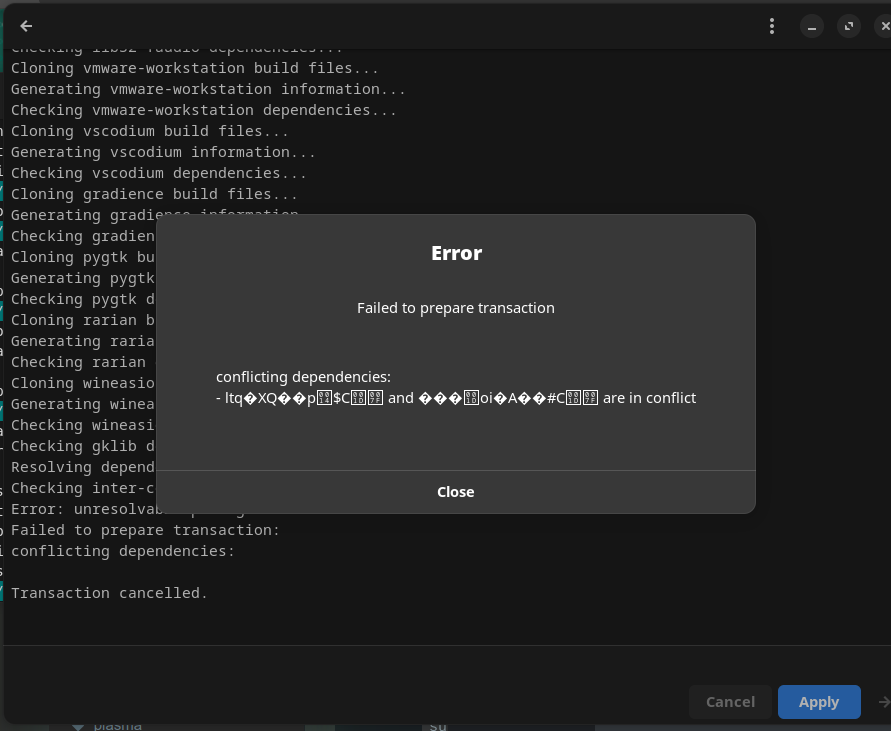

Im currently facing an issue where I try to update the software throw the software center ‘in gnome’ and I get the following error:
I tried to do `sudo pacman -Syu’ but nothing was there to update and the error message is not readable to be able to debug it using the software center.

I don’t think it is vmware-workstation I removed it and still getting the same issue.
Error: unresolvable package conflicts detected
Error: Failed to prepare transaction:
conflicting dependencies:
- ltq�XQ��pŒn� and ���oi�A ��n� are in conflict
is there a way to identify which packages are causing the conflict? this way i will need to go and remove all aur packages (which might not solve the issue)
the other thing is that the error message of which package are in conflict are unreadable as it shows above

after some tinkering I managed to solve the issue. I wrote some python script to delete all the aur packages from the system. some gave me an error as they are dependencies for other packages which I ignored (mainly python2 packages). after the update works fine. I’m still curious of why I got this weird conflict error with all the weird characters that made debugging and finding a solution almost impossible.
Take a look at /var/log/pacman.log to see if there are some clues, or next time try LANG=C sudo pacman -Syu to see if it’s more readable.
You did not need to write a whole script for this…
sudo pacman -Rsu $(pacman -Qm)
removes all aur. Be sure to clean the cache too.
