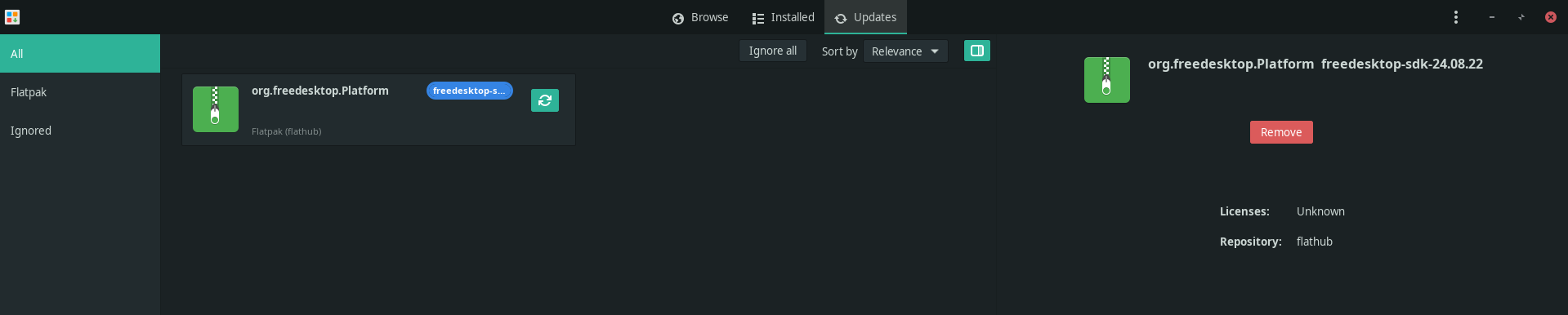

Org.freedesktop from flathub repo
Since yesterday, I’ve been getting this, and I can’t even remove it. Has anybody experienced this?

AFIK, I don’t have Flatbub repo enabled. Only AUR. That is the problem I can’t remove it.

For reference, another option might have been to simply update it; once updated, you would not be bothered until the next time updated components were available:
flatpak update
@soundofthunder Thanks! I have an unsolved update with “org.freedesktop.Platform freedesktop-sdk-24.08.22” which I tried with updating using pamac-gui, after I did “flatpak update” in terminal is solved.
