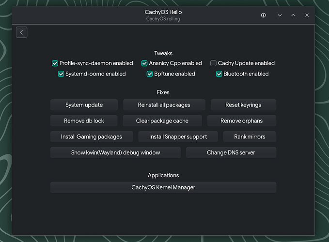

My original point was not the packages, as it’s hard to maintain, but suggesting to users a collection of simpler tweaks, as to have something to make them not miss out the optimized experience completely. For example, as mentioned, I’ve set up ananicy with CachyOS’ rules and zram, using a few commands, and I’ve also noticed the tweaks in CachyOS’ Hello menu as in the screenshot, which also seem like easy install. This is what I know about but there’s probably more similar stuff.
