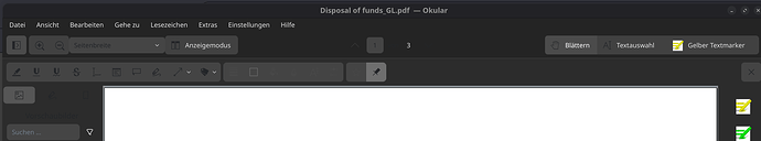

Hello all,
recently flatpak okular failed to run under wayland, so I switched to manjaro repo okular: after an update okular - and gnome document viewer - failed to open PDFs.
I fixed Gnome document viewer by symlinking libgpgmepp.so.6 to current libgpgmepp.so.7.
But Okular still has the error message:
„file:///home/leder/Sync/Banking /Disposal of funds.pdf“ kann nicht geöffnet werden ( )
Please troubleshoot with me!
Thanks in advance!
Best regards
Gerrit
Mod edit: changed “dokumentenbetrachter” to its English translation “document viewer”

Since some updates of pacman package “okular” I have in gnome dark mode the font colour black on dark grey background colour, can I configure this anywhere to readable settings?
qt6ct should be the place.
Thanks alot!
