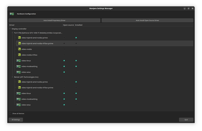

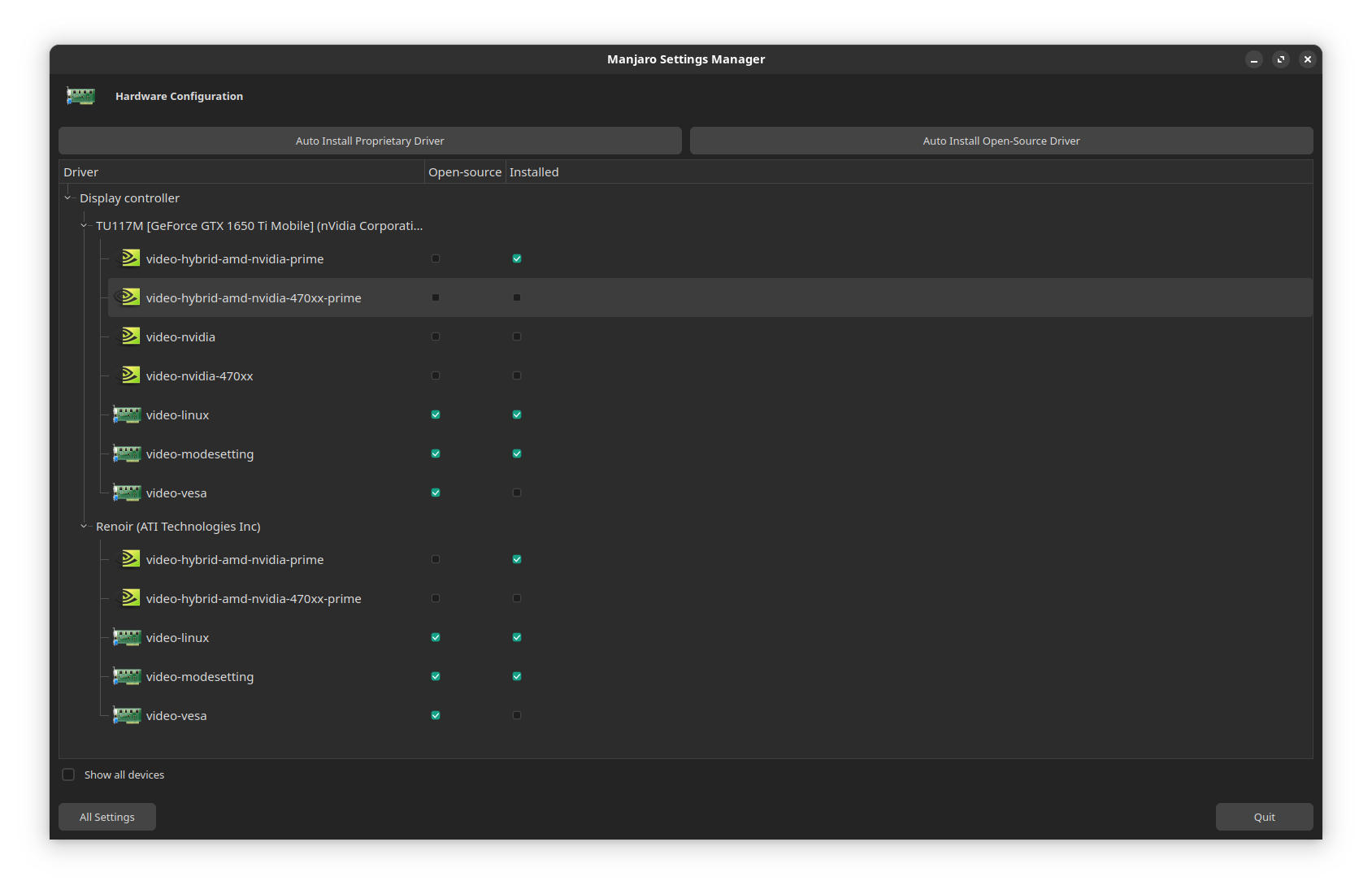

All that would normally be required is to select/install the relevant *prime* profile in mhwd.
(and then use prime-run)

I dont see how these can all be true at the same time.
Furthermore … do you mean that prime works now ?
