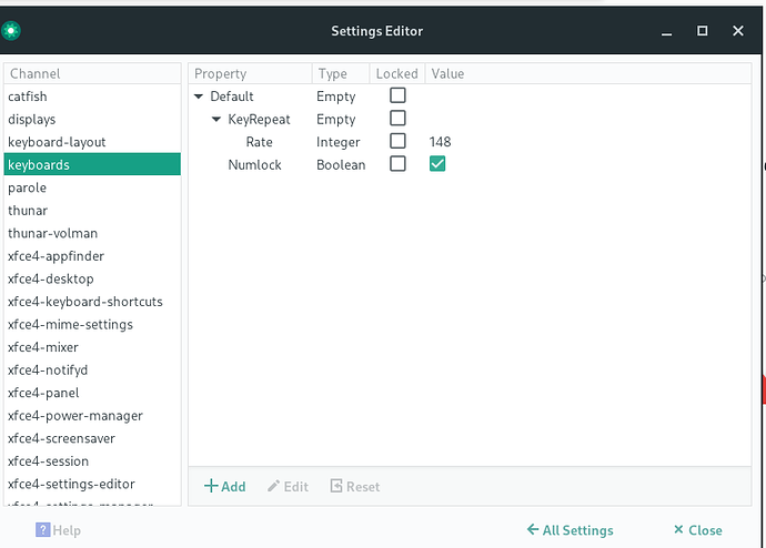

Have you tried in Settings Editor as in the screenshot:
I hadn’t tried that one until now, but i don’t see any options for enabling numlock, maybe i’m missing something?
Yes, i did try that one. Unfortunately i’m not allowed to media share or post links. Maybe because my account age is too short to be trusted? there are some differences to yours though. i do have the numlock key set to true, but i also have RestoreNumlock set to true. Should i disable that? also, i don’t have the KeyRepeat group, but i suppose that shouldn’t affect anything numlock related.
Do you suggest i change something in there?
