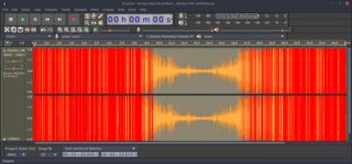

When I plug in my headset, I can hear everything clearly, the problem lies in the microphone: when I record it sounds oversaturated and I can hardly distinguish my voice. This problem is both with headphones and with the laptop’s own microphone, and I think it is not a problem of damaged hardware, since I have dual boot with windows 10, and there you can hear perfectly the internal microphone and the one of the headset. To illustrate it better, I recorded a test with OBS by raising and lowering the volume, I warn you that there are very loud noises:
youtube.com/watch?v=oN5hh5yLuzs
