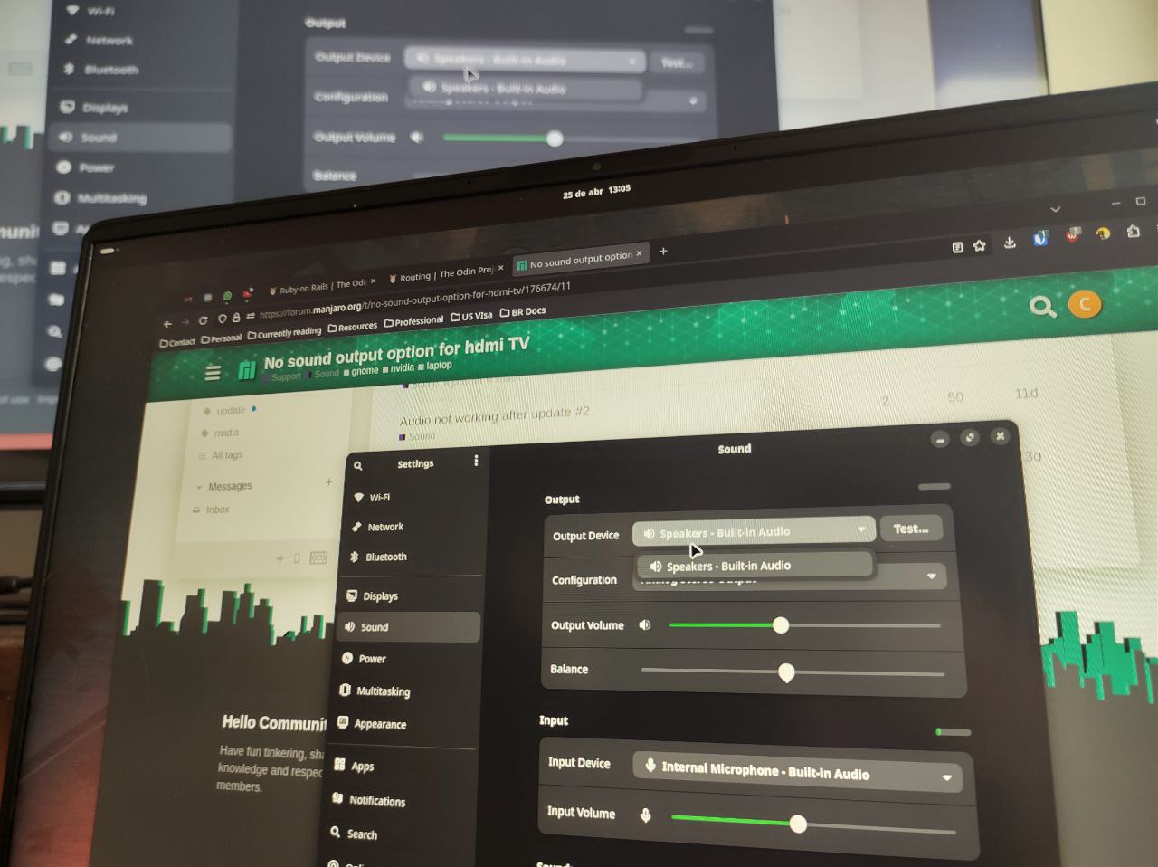

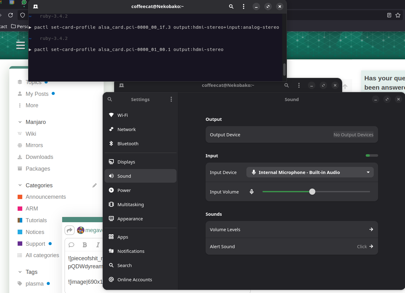

No sound output option for hdmi TV
I’ve tried the solutions of similar threads, so please bear with me.
Problem: No sound coming out of TV and no option to set it so. Upon connecting laptop to TV via hdmi cable. Sound output options only show laptop’s built-in speakers, but not the TV.
I would like to output the sound via the TV.
Everything else works fine: Display is ok. Cable is ok (the same hdmi cable plugged onto the same TV but getting sound from my Switch: works fine).
Please help? Thank you :pray:

Data shows no HDMI audio device detected in ALSA
On my system ALSA shows the model number of the Hanspree monitor

Have you tried switching profile via ‘pavucontrol’ (Configuration tab)?
What is currently returned by the pactl?
pactl list sinks | egrep -i "output|active"
pactl list cards | egrep -i "output|active"
pactl list cards in previous comment shows Profiles for all HDMI outputs on both audio devices are not available
egrep: warning: egrep is obsolescent; using grep -E
pactl list cards | grep -E "output|active"

Yeah, i dont know why that is. It is clearly connected and the display works.
Do you know the make and model number of TV?
Does TV have any settings to select different audio inputs, or mute the HDMI audio input?

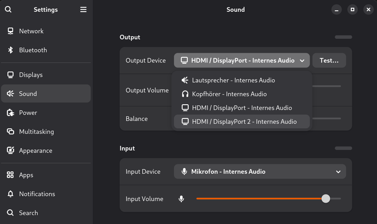

Looks like you did not choose a HDMI-Output profile. I have a similar audio device where I need to switch the profile. Only one audio output works at once.
Actually no. There are plenty of possible profiles:
Go to your Gnome Settings and choose it?
I literally do not see those options in my sound output settings. I have told you I tried that. Why don’t you believe me?
Because pactl shows the profiles, and you didn’t prove that gnome-control-center or pavucontrol doesn’t display it. We can only work with data we see.
This profile is chosen:
using hdmi, you need to switch to:
Try this:
pactl set-card-profile alsa_card.pci-0000_00_1f.3 ouput:hdmi-stereo+input:analog-stereo
or
pactl set-card-profile alsa_card.pci-0000_01_00.1 output:hdmi-stereo
since Nvidia has:
Try this:
or
I think we’ve made it worse.
Install and open pavucontrol. Go to Configuration and set the profile there.
Ok, pavucontrol gives me ■■■■■■■ of output options that gnome settings does not. Thankfully I finally found one that worked!
So thank you for your help. I do wish I could prevent this from happening in the first place. It’s not like I even knew how to change any of these configs outside of gnome settings to have messed them up somehow.
