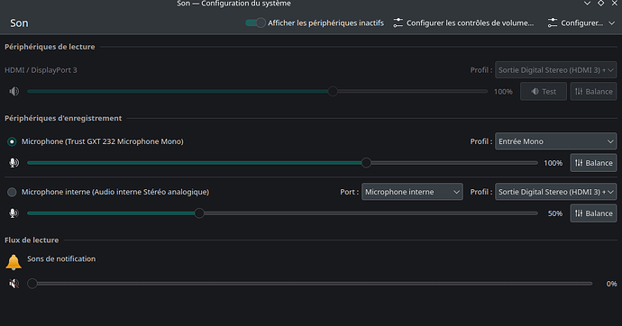

I have updated my packages using pacman -Syu today. I have also removed orphans packages. After rebooting, I noticed that no sound was coming out of my computer, whatever the speakers I was using.
As you can see, in the system configuration panel, the audio output is flagged as “inactive:”

I installed pavucontrol, changed the output device a few times and it ended up working. The outputs are no longer disabled in the sound configuration panel. Thank you!
