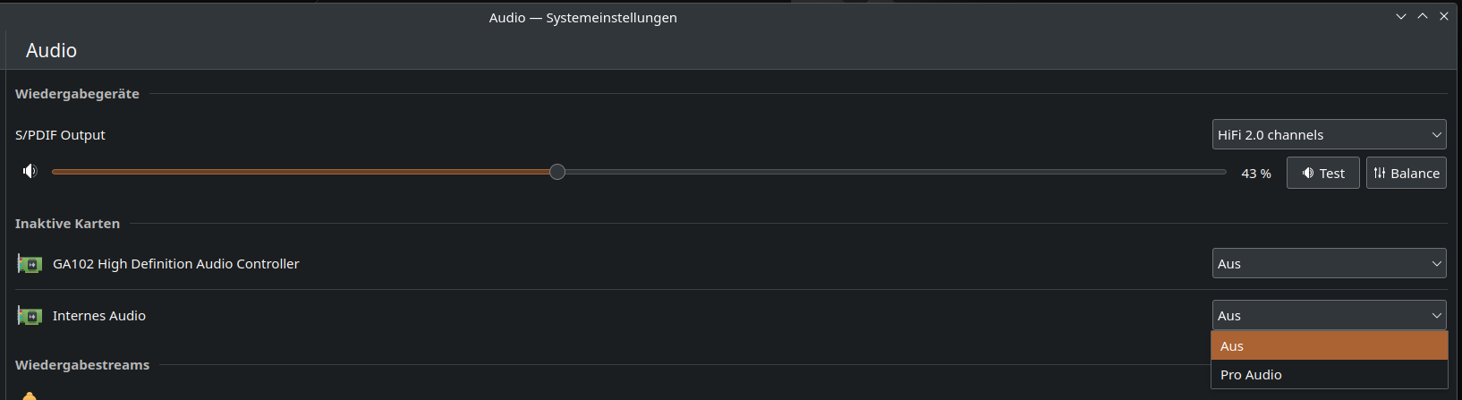

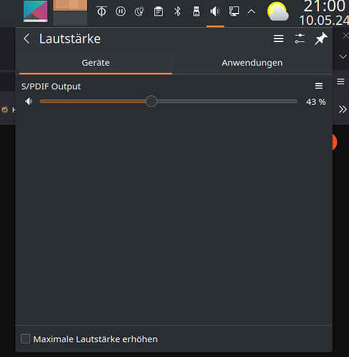

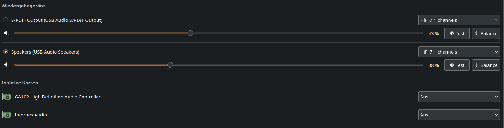

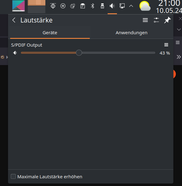

Hello manjaro community, new guy here:
I’ve recently upgraded my hardware, including my mainboard - from MPG Z390 to a MPG Carbon Z790 to be precise - and my system no longer gives me a line out device to play sound through. I have a headset connected via USB which works fine, but I’d like my line out back. I’m using pipewire and the latest 6.8 kernel.
I’ve tried a few things like reinstalling sof-firmware, switching from pipewire to pulseaudio (and back to pipewire), going to the 6.6 LTS kernel, but no luck with solutions this easy, I’m hypothesizing there is propably some conflict with existing configuration from the prior hardware but I’m out of my depth here and would love some pointers from the experienced users here.
Some system information:
Output of inxi -SMAa

and the output of pactl list cards :
Card #39
Driver: alsa
Owner Module: n/a

Card #41
Driver: alsa
Owner Module: n/a
Properties:
api.acp.auto-port = "false"
api.alsa.card = "2"
api.alsa.card.longname = "Generic USB Audio at usb-0000:00:14.0-13, high speed"
api.alsa.card.name = "USB Audio"

Card #42
Driver: alsa
Owner Module: n/a
Properties:
api.alsa.card = "3"
api.alsa.card.longname = "HDA Intel PCH at 0x6404120000 irq 169"
api.alsa.card.name = "HDA Intel PCH"
api.alsa.path = "hw:3"
api.alsa.use-acp = "true"
api.dbus.ReserveDevice1 = "Audio3"
device.api = "alsa"
device.bus = "pci"
device.description = "Internes Audio"
device.enum.api = "udev"
device.icon_name = "audio-card-analog-pci"
device.name = "alsa_card.pci-0000_00_1f.3"
device.nick = "HDA Intel PCH"
device.plugged.usec = "15692416"
device.product.id = "0x7a50"
device.subsystem = "sound"
sysfs.path = "/devices/pci0000:00/0000:00:1f.3/sound/card3"
device.vendor.id = "0x8086"
media.class = "Audio/Device"
factory.id = "14"
client.id = "32"
object.id = "42"
object.serial = "42"
object.path = "alsa:pcm:3"
alsa.card = "3"
alsa.long_card_name = "HDA Intel PCH at 0x6404120000 irq 169"
device.string = "3"
Profiles:
off: Aus (sinks: 0, sources: 0, priority: 0, available: yes)
output:hdmi-stereo: Digital Stereo (HDMI)-Ausgabe (sinks: 1, sources: 0, priority: 5900, available: no)
output:hdmi-stereo-extra1: Digital Stereo (HDMI 2)-Ausgabe (sinks: 1, sources: 0, priority: 5700, available: no)
output:hdmi-stereo-extra2: Digital Stereo (HDMI 3)-Ausgabe (sinks: 1, sources: 0, priority: 5700, available: no)
output:hdmi-stereo-extra3: Digital Stereo (HDMI 4)-Ausgabe (sinks: 1, sources: 0, priority: 5700, available: no)
output:hdmi-surround: Digital Surround 5.1 (HDMI)-Ausgabe (sinks: 1, sources: 0, priority: 800, available: no)
output:hdmi-surround71: Digital Surround 7.1 (HDMI)-Ausgabe (sinks: 1, sources: 0, priority: 800, available: no)
output:hdmi-surround-extra1: Digital Surround 5.1 (HDMI 2)-Ausgabe (sinks: 1, sources: 0, priority: 600, available: no)
output:hdmi-surround71-extra1: Digital Surround 7.1 (HDMI 2)-Ausgabe (sinks: 1, sources: 0, priority: 600, available: no)
output:hdmi-surround-extra2: Digital Surround 5.1 (HDMI 3)-Ausgabe (sinks: 1, sources: 0, priority: 600, available: no)
output:hdmi-surround71-extra2: Digital Surround 7.1 (HDMI 3)-Ausgabe (sinks: 1, sources: 0, priority: 600, available: no)
output:hdmi-surround-extra3: Digital Surround 5.1 (HDMI 4)-Ausgabe (sinks: 1, sources: 0, priority: 600, available: no)
output:hdmi-surround71-extra3: Digital Surround 7.1 (HDMI 4)-Ausgabe (sinks: 1, sources: 0, priority: 600, available: no)
pro-audio: Pro Audio (sinks: 4, sources: 0, priority: 1, available: yes)
Active Profile: off
Ports:
hdmi-output-0: HDMI / DisplayPort (type: HDMI, priority: 5900, latency offset: 0 usec, availability group: Legacy 1, not available)
Properties:
port.type = "hdmi"
port.availability-group = "Legacy 1"
card.profile.port = "0"
Part of profile(s): output:hdmi-stereo, output:hdmi-surround, output:hdmi-surround71
hdmi-output-1: HDMI / DisplayPort 2 (type: HDMI, priority: 5800, latency offset: 0 usec, availability group: Legacy 2, not available)
Properties:
port.type = "hdmi"
port.availability-group = "Legacy 2"
card.profile.port = "1"
Part of profile(s): output:hdmi-stereo-extra1, output:hdmi-surround-extra1, output:hdmi-surround71-extra1
hdmi-output-2: HDMI / DisplayPort 3 (type: HDMI, priority: 5700, latency offset: 0 usec, availability group: Legacy 3, not available)
Properties:
port.type = "hdmi"
port.availability-group = "Legacy 3"
card.profile.port = "2"
Part of profile(s): output:hdmi-stereo-extra2, output:hdmi-surround-extra2, output:hdmi-surround71-extra2
hdmi-output-3: HDMI / DisplayPort 4 (type: HDMI, priority: 5600, latency offset: 0 usec, availability group: Legacy 4, not available)
Properties:
port.type = "hdmi"
port.availability-group = "Legacy 4"
card.profile.port = "3"
Part of profile(s): output:hdmi-stereo-extra3, output:hdmi-surround-extra3, output:hdmi-surround71-extra3
I’m assuming Card #42 relates to my internal audio device, but it only has HDMI outputs, wheras the USB device, which is used for the wireless headset. has a non-existing line-out, so I’m guessing something is configured wrong but I don’t even know where to start and how to properly read what I’m seeing. Any help is greatly appreciated, cheers.
