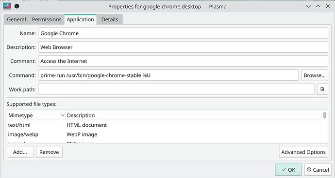

Looks like there’s some confusion between application command exec string and krunner behaviour.

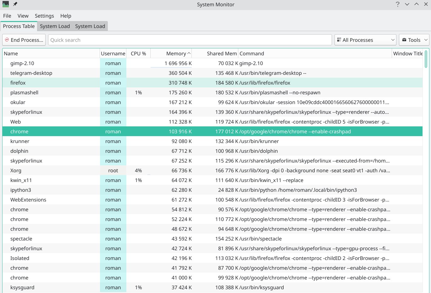

For ex. google chrome has exec string prime-run /usr/bin/google-chrome-stable %U but in process list it shows /opt/google/chrome/chrome as the command the chrome process was run with.
When I run gimp through app menu or krunner shortcut - it’s not shown in nvidia-smi list, though it’s pretty heavy process.
thats where the prime-run should be placed…

That’s how I did with all the needed apps including chrome and gimp. Prepended, rebooted and then, wrote my previous comment with screenshots.
No. As well as gimp.
