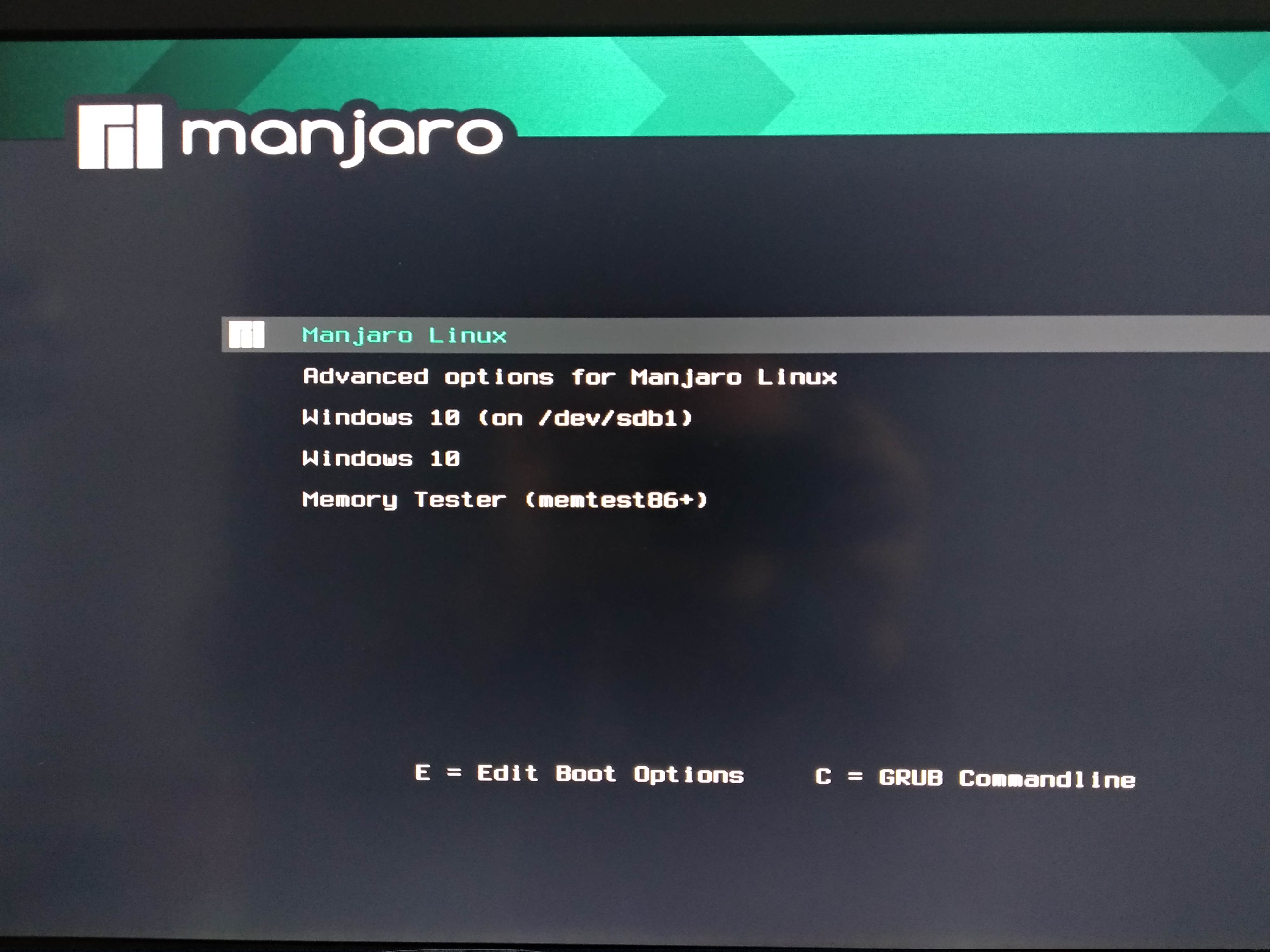

If I now boot via liveCD and run this grub commands:
It starts the grub with the needed entries:

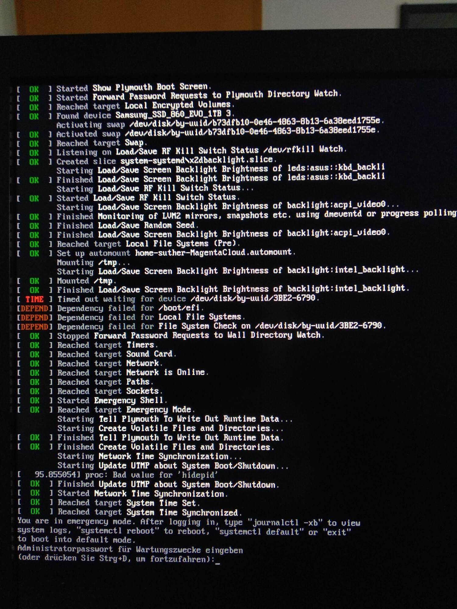

I do choose Manjaro, and the boot process stuck on trying to mount the device:

this very bad :
on boot USB then disk , the disk sda is GPT , and is looking for /boot/efi …
that is present in /etc/fstab ( check this on your disk )
installation is Bios on sdb , so you have mixed GPT/MBR format
