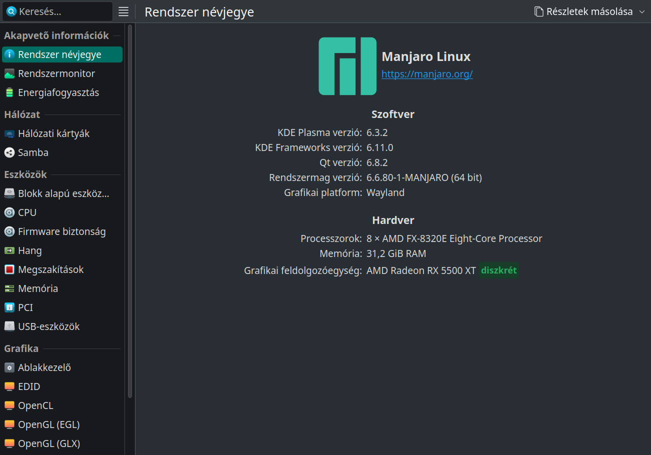

Since yesterday’s update, the monitor is playing in a terribly blue 6500 K and a greenish 3000 K nighttime color, and the contrast has shifted, everything has become a little duller. I installed redshift, but it won’t start.
How do I recalibrate the colors in the system?

Hi,
Wayland was the cause of the problem. I switched to X11 and everything is great there.
Thanks for the help!
