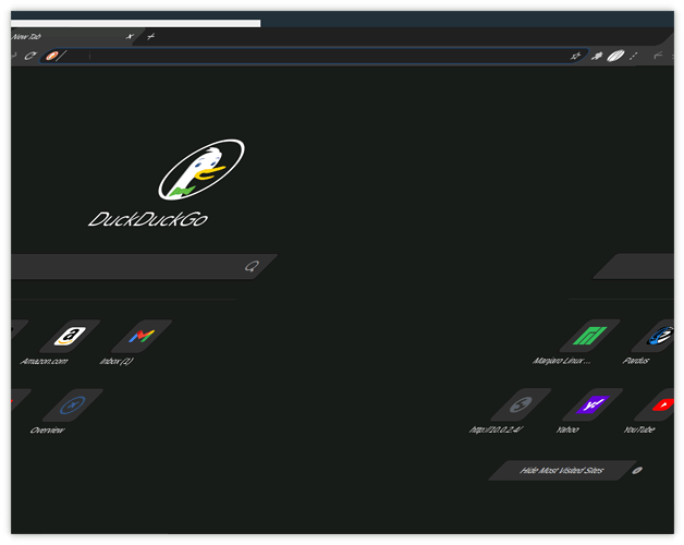

booting continues and my graphical interface comes up… but is messed up.
Chromium:
System Settings:
I got that a few weeks ago when I compiled the upstream kernel to test where they were with support for the pi4. The problem was my VIZIO tv not getting recognized properly. I had an old computer monitor I hooked up and the picture was perfect. But your issue seems to be with a program. Mine was with the desktop and all programs
The strange think with the issue is I took a screenshot to show strit and the screenshot looked perfect.
Have you tried deleting the ~/.config/chromium ~/.cache/chromium directories to flush things out?
No, I have not really tried much to fix things. It starts to get into the “if it is hard, I’m probably doing it wrong” area. :slight_smile:

chromium is fine and so is my System Settings. However, still have the kwin compositor failing but glxgears runs properly.
