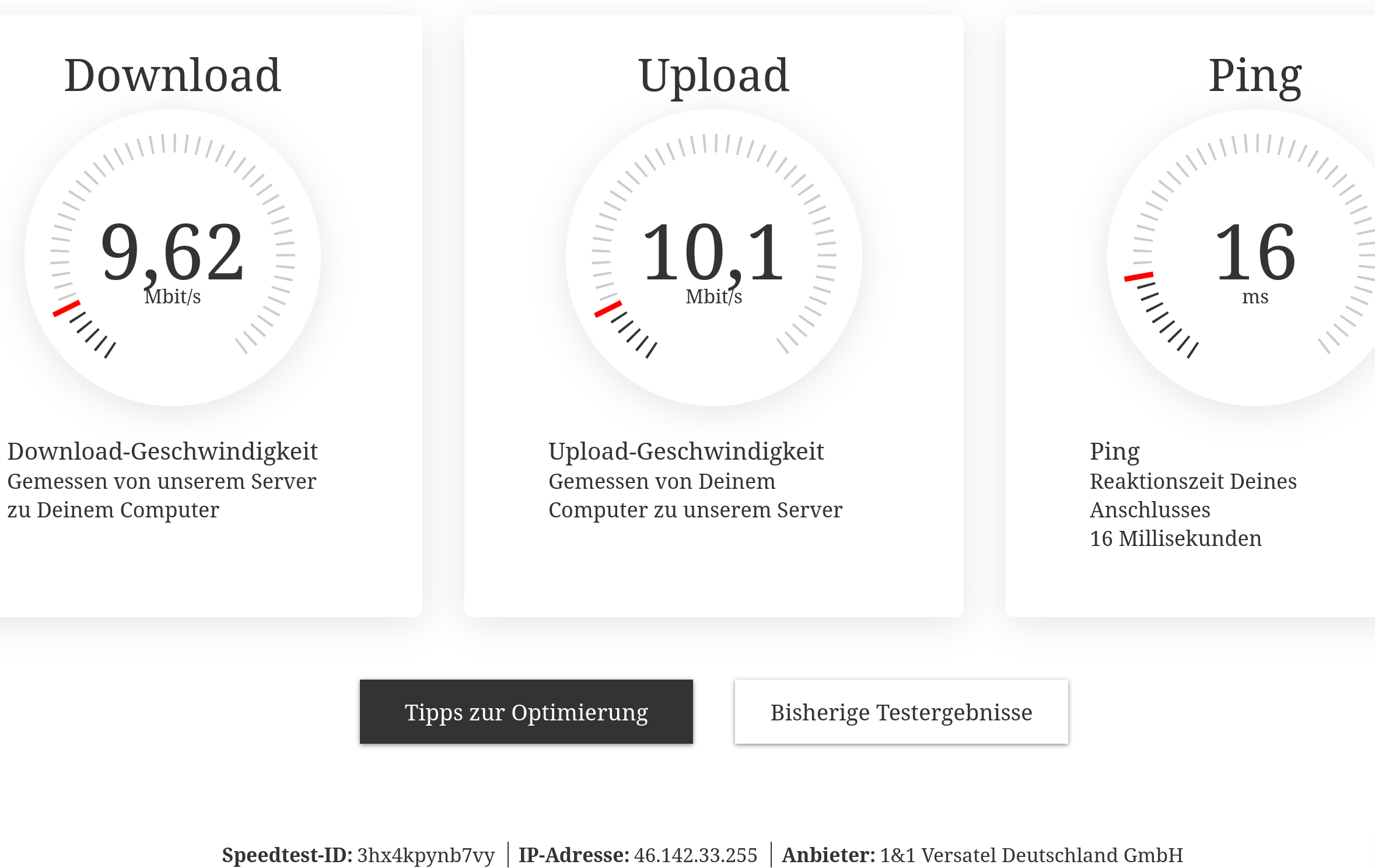

Description. Since 09/06/2023, no LAN/network is available after reboot (unless UEFI trick is applied, see below). Internet speed is only ~10% (about 10 mbit of 100 mbit), absoulut lame. See screenshots.

  • I tested the Fritz-Box (router) with another device (cell phone, only WLAN on). Speed fully there, no problems. Various speedtest on the computer very slow and surfing feels extremely lame

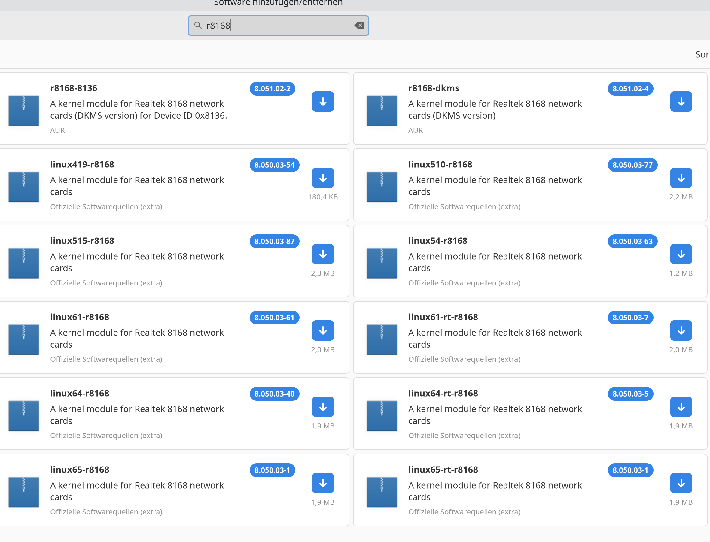

Uninstall the r8168 driver module by way of the Manjaro Settings Manager and use the in-kernel r8169. :wink:
It is not installed. Maybe I understand someting wrong? Thanks for your help!
Your screenshot here — and this is why you should copy and paste instead of inserting terminal screenshots, because now I have to include it in the quotes — says otherwise… :arrow_down:

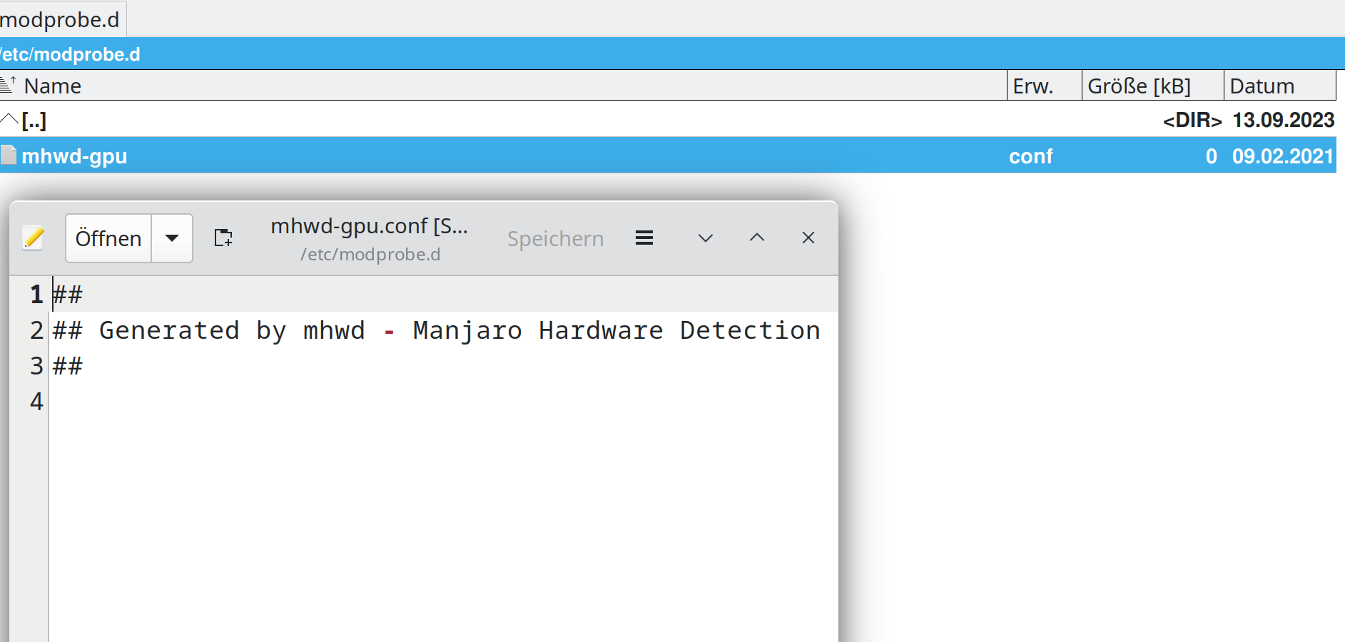

Check if you have r8169 blacklisted in /etc/modprobe.d/. If it’s blacklisted, remove it from the blacklist.
Sorry, don’t know how to get this information better in a text. :frowning: I see there no blacklisting. Thanks.
Again, please do not post screenshots of things that can be copy/pasted with the mouse.
Your inxi screenshot shows that you are running the r8168 driver module. Uninstalling that module does not remove it from the running kernel.
If the r8168 module has been uninstalled and you don’t have a blacklist on r8169, then you must reboot in order to load r8169. But before you do that, perhaps it is best to rebuild your initcpios and update your boot loader… :arrow_down:
