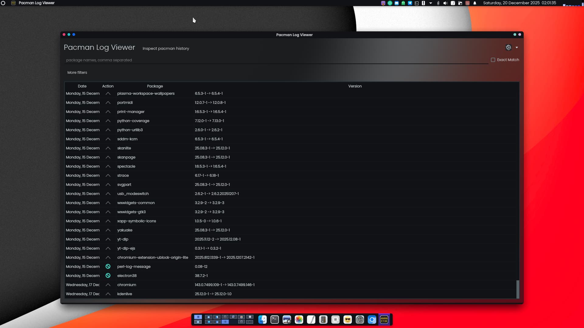

The log viewer suggested by @Aragorn was nice, with colors and everything. I installed that later, when I was up and running.
I will therefore mark his response as the solution, although I read about all the rest of the things people said also and I will maybe implement a few more things later.
Thanks to you all.
If you’re on Plasma, then there’s also a GUI version of it. :backhand_index_pointing_down:
sudo pacman -S pacmanlogviewer
Thanks, but the Terminal version is perfectly okay, since I wanted something for the TTY. It is probably only then I will be using it, since I always go via the TTY when I update the system. Work order is: reboot, TTY and update, reboot while keeping fingers crossed … and if I can get my fingers unstuck, I’ll even log in after. 8)
