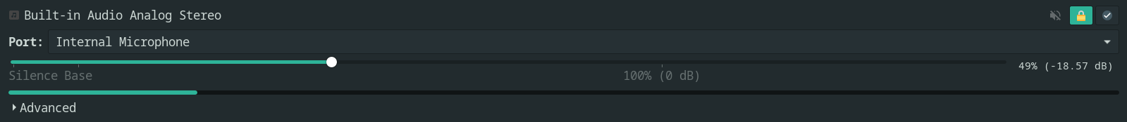

But when I try to use something like gnome recorder, nothing it picked up. So, is it actually there, or is this some kind of bug? It’s not important at all, just strange.
Actually it is functioning. Look at the level swing But the thing about cheap mics is that they are practically unusable without noise reduction. See Noise Torch for example.
Yeah, that’s the weird thing. pavucontrol indicates that it’s actually working, but the recordings from the recording application don’t pick any noise up whatsoever, so matter how loud I get. Is there a way for me to find more information on the hardware aspect of this?

Interesting commands, but I wasn’t able to really glean much more information than I already know. But yes, pactl clearly states that there is indeed an internal microphone, something that I was not aware existed. Now the questions remains as to why it doesn’t seem to actually work, despite pavucontrol showing that it does actually pick up sound.

Just a notice: gnome-sound-recorder just pick the default input device, which is usually the first one. In that case it records sound of my internal audio (when playing music for example). You have to set the default device in pavucontrol for example .
Wow, it works. Interesting. Is there a way for me to block it at the software level? Perhaps something I could blacklist. If not, that’s perfectly fine.
User should be able to change recording source in pavucontrolRecording tab using drop-down menu. If that is not possible with gnome-recorder use another sound recorder
