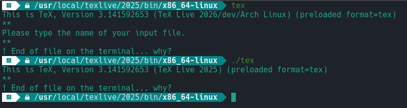

path+=/usr/local/texlive/2025/bin/x86_64-linux
When I check the output of tex vs navigating to the new install and running that file directly, I see:

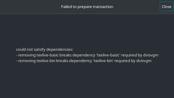

How do I go about migrating to native tex install? I tried uninstalling the texlive that came prepackaged with Manjaro and (thankfully) it warned me that
remove the dependency as well (dvisvgm)
Hi, if you don’t need dvisvgm you can remove it, anyway for faking the presence of the texlive package you can install AUR (en) - texlive-dummy , this is an empty pkgbuild to satisfy the package manager
