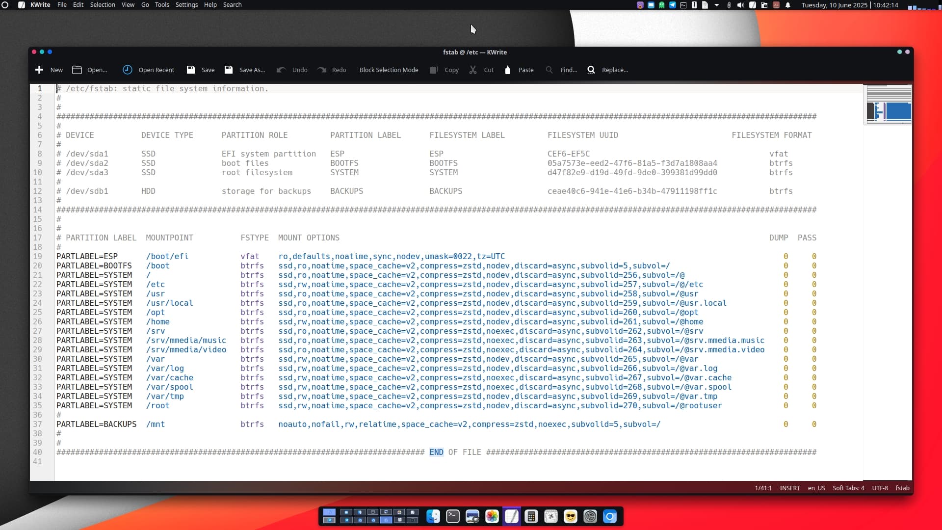

Well, that’s an interesting point, because even though virtually everyone here uses btrfs for its ability to make snapshots, I don’t use snapshots, and I even doubt whether I would be able to create any usable filesystem rollback setup without much tinkering.
I prefer real, physical backups on a separate medium — with timeshift, indeed — and I am using btrfs for very different reasons, i.e. because it uses B-trees, because it’s copy-on-write, because it supports transparent inline compression, because it maintains checksums on both the metadata and the data, and because it has subvolumes which largely behave as independent partitions — with their own specific mount options — while they still share the total amount of free space with the other subvolumes on the device.
I’ll spare you the left-and-right scrolling and instead show you my /etc/fstab as a screenshot. Then you can see for yourself what I’m talking about. :stuck_out_tongue:
:point_down:

Yes, all my patch does is add a conditional check to see whether the filesystem to be chrooted into is btrfs or a more traditional filesystem, and in the case of btrfs, it then modifies the path to the /etc/fstab file, so that it can be read by /usr/bin/mount. If it’s not btrfs, then nothing changes. :wink:
