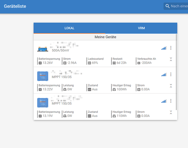

Hello everyone,
i am trying to run VictronConnect as appImage. It’s a management and monitoring software for Victron products (inverter, solar charger etc.)
The application GUI loads, but crashes two seconds later with a memory access error (Speicherzugriffsfehler).

I just can confirm it crashes on me too. XFCE, X11 session. There was some log in the tmp folder but it did not seem helpful. I have coredump files disabled so i cannot help further.
p.s. after a little bit of investigating…seems the newer version miss the libQtBluetoothLocal.so.1 and no package in the arch world or aur has this. As a workaround you can use an older version, seems to work fine at least with the demos

Interestingly the new version launches exactly once, my devices are recovered. But as i am not using the default pin, i need bluetoothctl to determine it.
And then it crashes…
On every next launch in the same session it crashes a second after launch. Until the next reboot…
