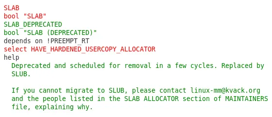

The Linux SLAB allocator is officially deprecated - better , more optimal resource management using SLUB if i understand the article correctly
