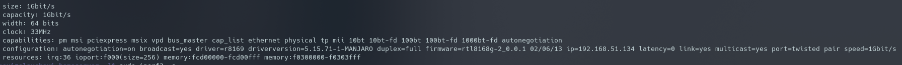

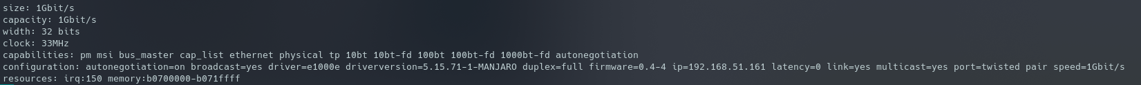

I have a PC and a home server both running Manjaro Linux. They are connected to eachother through an Asus router and all devices are capable of, and used to run at 1Gbit/s since I set them up.
Today for the first time I noticed some slowness on the side of the server. I ran an iperf3 connection test and saw that my PC was only accessing my server at 100Mbits/s:
Screenshot_20221009_222621
Running a lshw -C network on both devices reveals that they are both still capable of, and linked at 1Gbit/s, with auto-negotiation and full duplex on.
Main PC:
Server:
However any real test or usage of the connection actually runs at 100Mbits/s. I have no idea what is going on at this point. I have checked the settings on my router and there doesn’t seem to be anything limiting the speed. I haven’t reconfigured anything, or updated any software or firmware that is related to networking, and the connection was running at the full 1Gbit/s speed yesterday. What could be causing this issue?
Thanks in advance!
