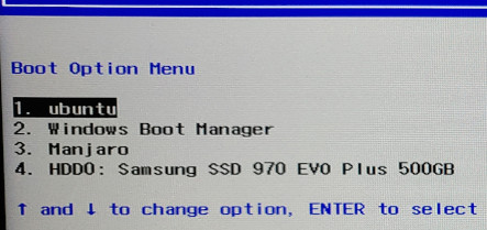

On top of what @ManjaroDevOps wrote, did you try to use the Boot Override option of Computer B to specifically select the manjaro EFI boot entry?
Here’s an idea of what that looks like:
example-boot-override-menu
I created a new boot option in BIOS (didnt knew thats possible to manually choose boot file path) and now it works, thanks.
