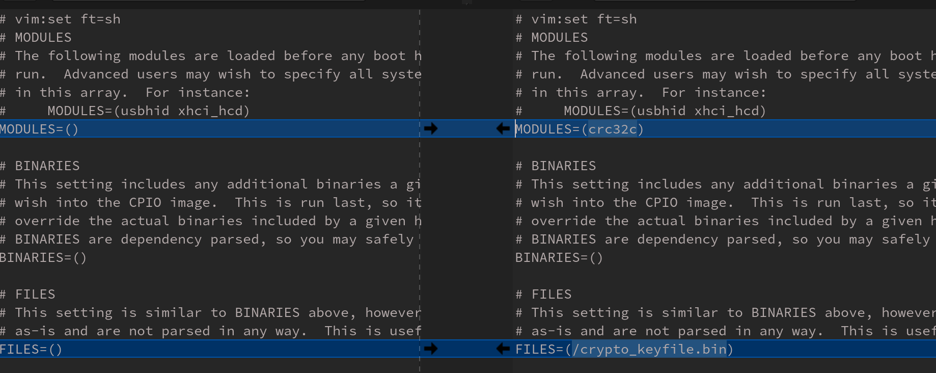

Looking at /etc/mkinitcpio.conf.pacnew now. Pretty sure I need to keep the settings on the right…
Many of the changes are to commented-out text which is replaced or added to by other commented out text. The one major line I’m concerned with now is the HOOKS setting:
.pacnew version:
HOOKS=(base udev autodetect microcode modconf kms keyboard keymap consolefont block filesystems fsck)
Existing version:
HOOKS=(base udev autodetect kms modconf block keyboard keymap consolefont plymouth encrypt filesystems)
keep the existing version - the .pacnew is the default without adaptations to your system
especially the “encrypt” HOOK and the FILES … is presumably needed and isn’t present in the default
the plymouth is for the boot animation which would be gone when it was not present anymore
I have retained my existing mkinitcpio.conf file and discarded the pacnew. Thank you.

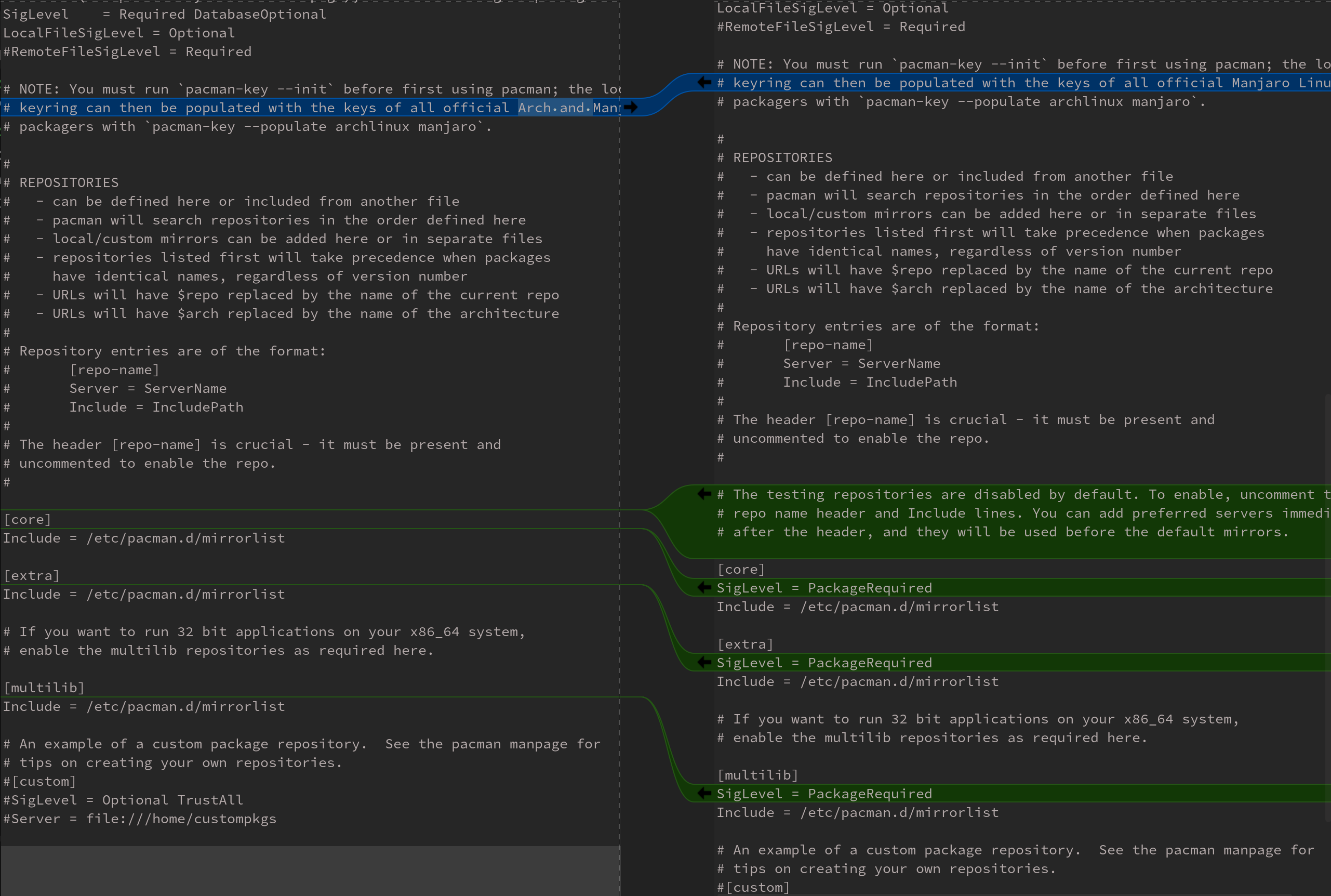

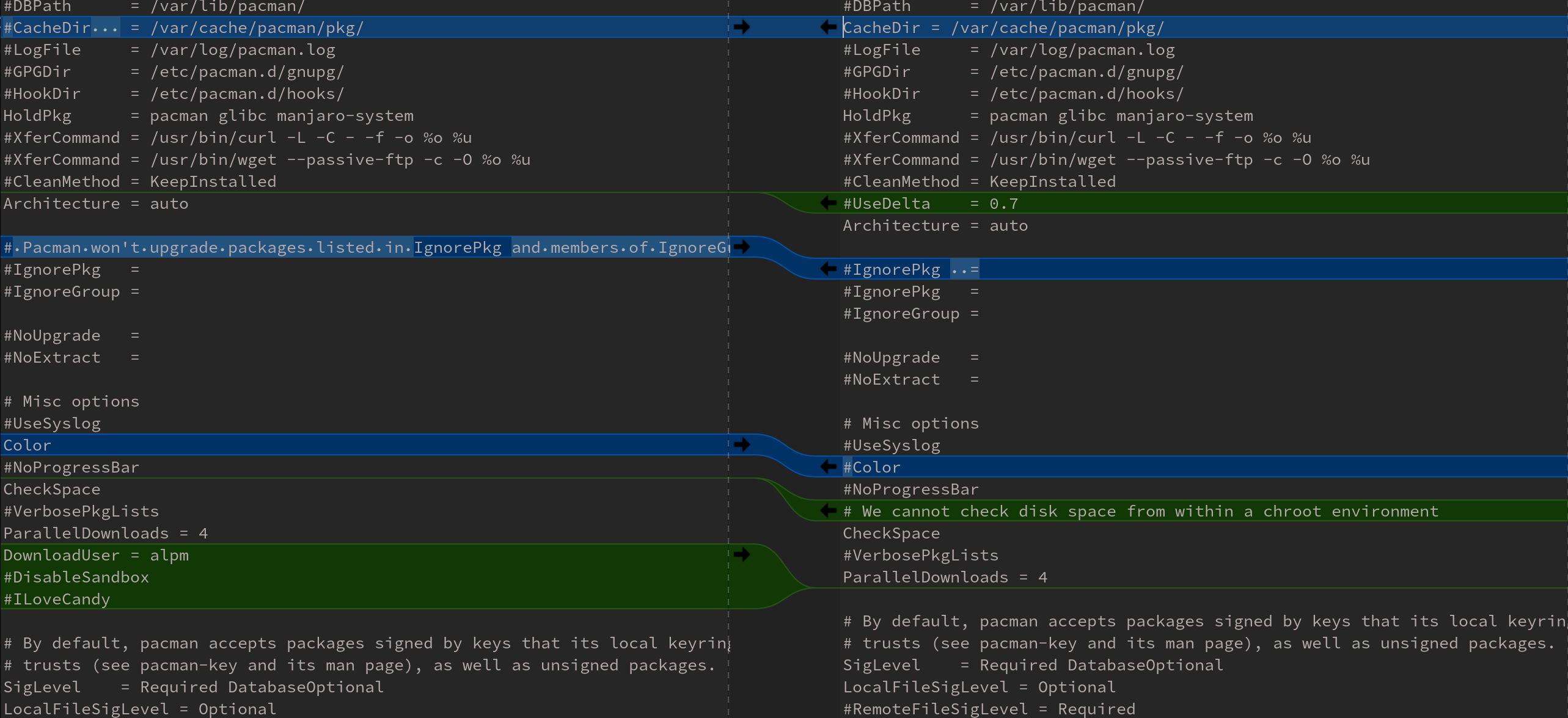

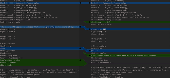

I’m now down to the pacman.conf.pacnew file.
Most of the settings seem unchanged, but there are a few I’m not sure about. Here are some shots of what I’m looking at:
And these:
For the core, extra, and multilib settings, I’m assuming I should keep the SigLevel settings?
If they are not in the .pacnew file, then you don’t need them. Unless you have added custom repositories to your pacman configuration, you should be able to just overwrite the old /etc/pacman.conf file with /etc/pacman.conf.pacnew.
