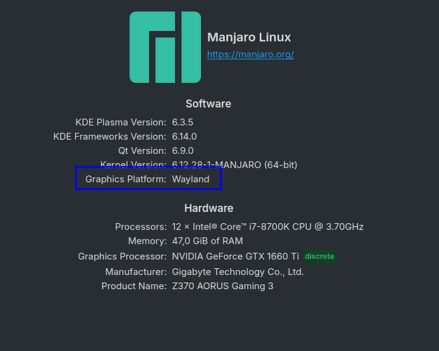

Q: How can I check if I’m using Wayland?
A: Check About this System in System Settings.
