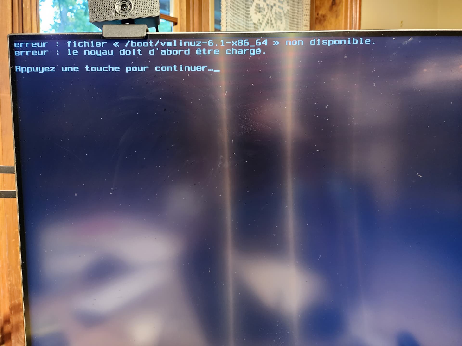

I have Manjaro ( KDE plasma) on a drive and I have Window11 on a second drive and I use Grub bootloader for dual boot ( see image 1)
This setup was working perfectly since may 2023 and since last week, I can no longer boot Manjaro . I can boot Window no problem. In Manjaro, I use mostly photo editing software so I do not make any changes to Manjaro configuration. The last time that Manjaro was working, I installed an Apimage of DigiKam. When i turned off the computer, Manjaro took a lot of time to shut down.
Now, when I boot Manjaro, I get an error message : «/boot/vmlinuz-6.1-x86_64» is not available and the kernel needs to be loaded (see image 2)

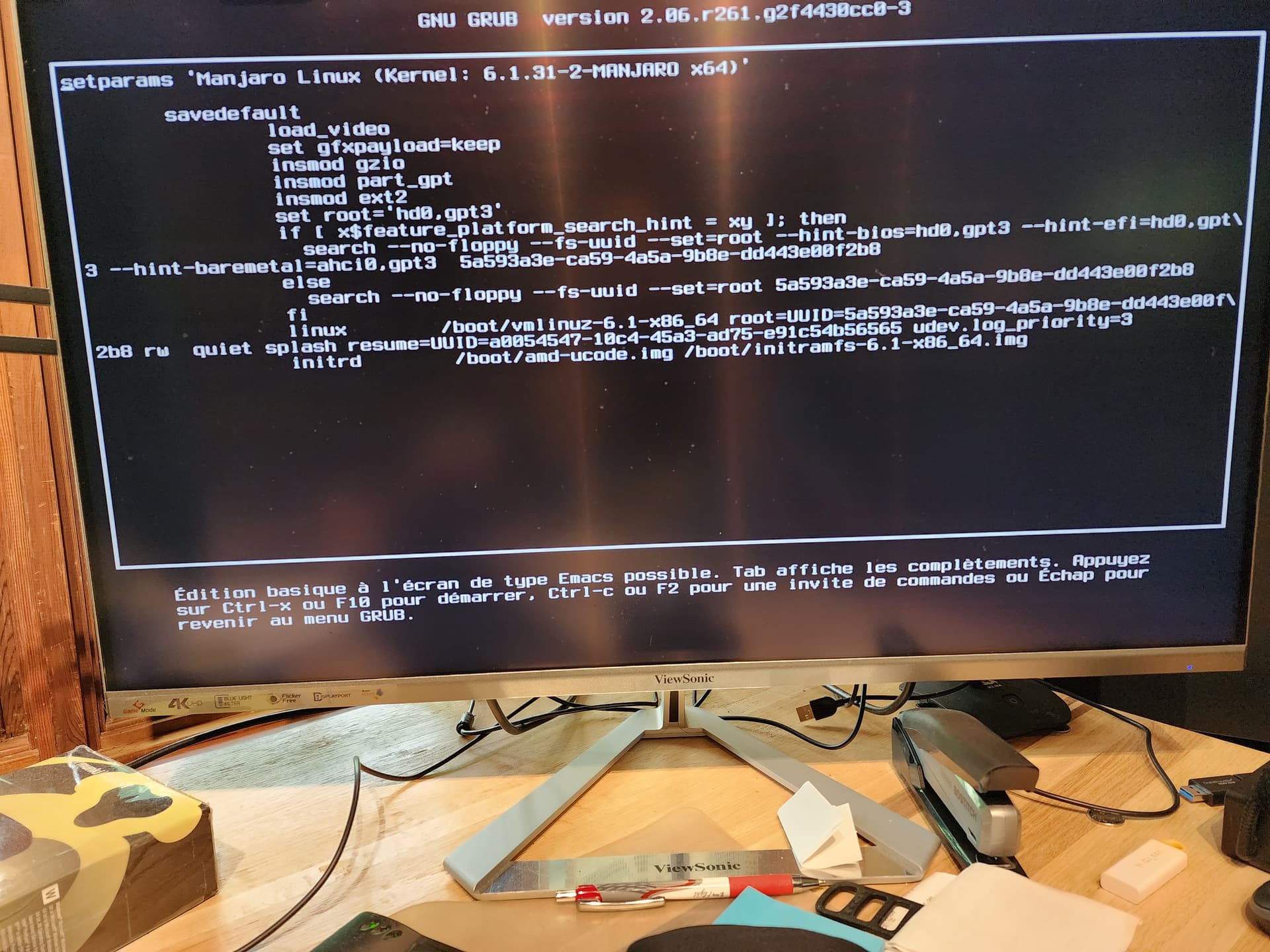

I found some information on grub commands to see if the configuration file was pointing at the right file structure ( hd0,gpt3) and it seems to be OK ( some videos mentionned possible file corruption in Grub.) ( see image 3)

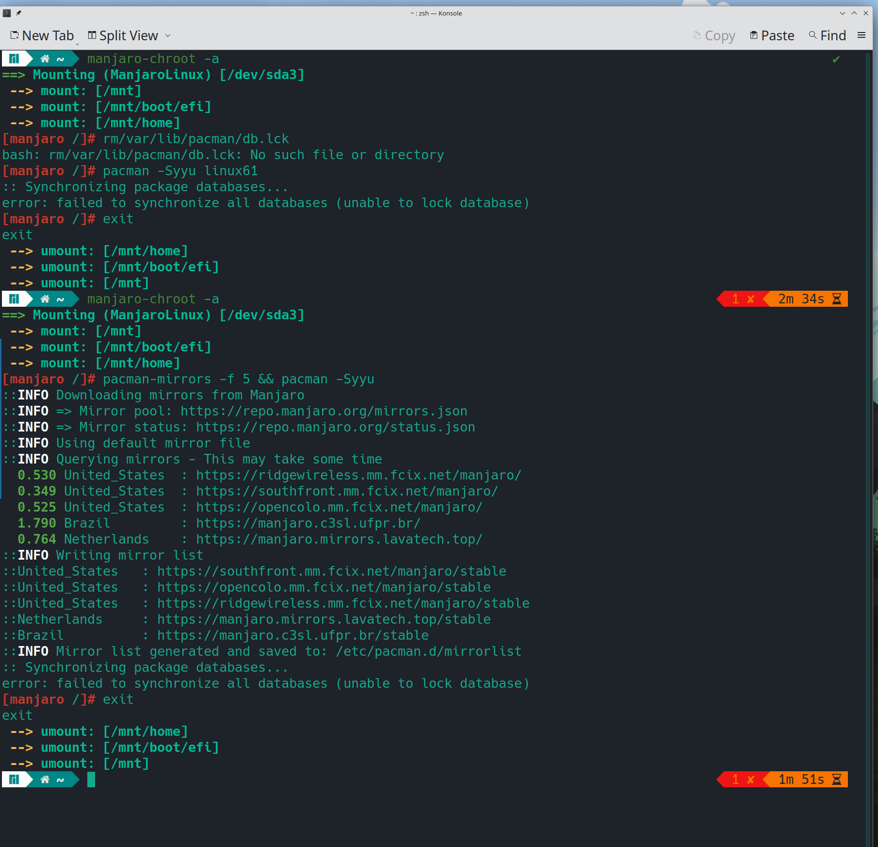

Thank-you brahma for your fast response.
I rebooted Manjaro with a USB and followed your instructions and the following image shows all the commands and the results.
I exited and rebooted the PC and the same problem occures when I select Manjaro from Grub bootloader: Manjaro does not start.
I hope that you have a few minutes to help me out.
Kind regards
Michel
Well you didnt do any updates.
It failed with
error: failed to synchronize all databases (unable to lock database)
The mhwd command afterwards likewise failed for the same reason.
So … there is a problem and you did not make any changes.
Of course it is the same result when you boot.
Maybe you should remove the lock file and try again.
Ex:
manjaro-chroot -a
rm /var/lib/pacman/db.lck
pacman -Syyu linux61
exit
Hello CSCS,
Thank-you for your response, I entered your commands and the fail to synchronize error still occurs. see image:
Thank-you to take some time to suggest other command lines to help me out. All this is very new to me.
Regards
Michel
You have a typo.
You did not put a space between rm and the file path.
(thus nothing was deleted)
Though the error did change somewhat nonetheless, which is interesting.
Anyhoo … run the command(s) again please and make sure to include all the spaces. :slight_smile:
