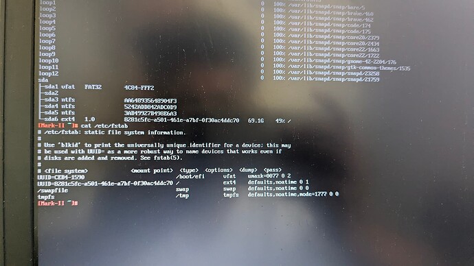

First it was a recovery partition which I accidentally deleted ig it has something related to grub or bootloader. I was able access only windows after that manjaro was not at all visible in the boot menu. Then I tried the live usb. Mounted the root partition then mounted boot efi partition. Then reinstalled grub. When I rebooted I was able to access manjaro but when I booted into that boot screen was there for a long time then this error screen came you’re in a emergency mode or whatever.

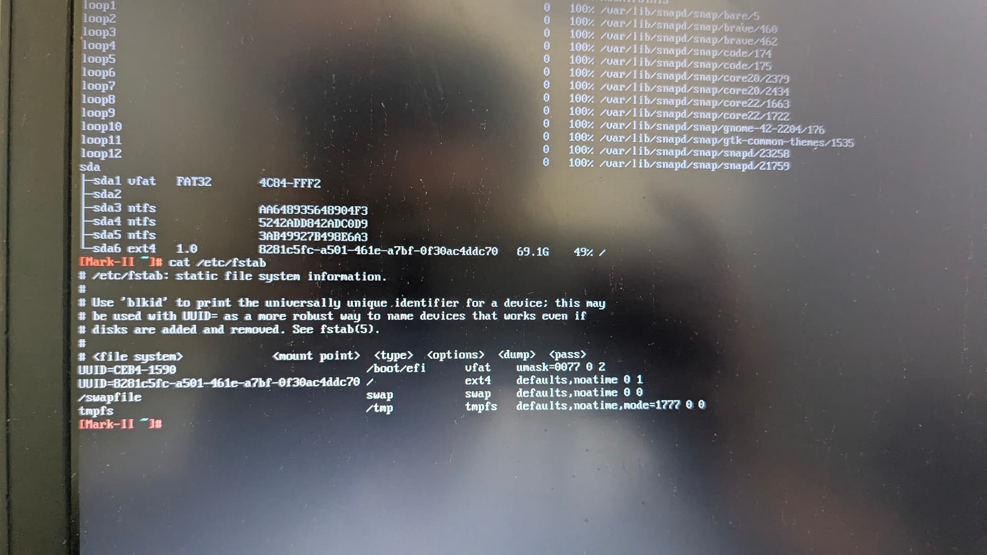

/dev/sda1 is probably your EFI partition - UUID ends in FFF2
In your picture it is not (yet) mounted to /boot/efi.
But in your /etc/fstab, this UUID is a different one - UUID ends in 1590
If these are supposed to be the same - they need to match.
Currently, /etc/fstab points to a partition which doesn’t exist.
Adapt /etc/fstab.
However they became different is a thing only you can know.

If I understand correctly, you deleted and your $ESP and have now created a new one; your respective UUID’s seem to confirm this.
Your /etc/fstab points to the old UUID of the $ESP (before you deleted it) but the UUID has changed on your new freshly formatted partition. This is expected (one should never randomly delete the $ESP).
One way to resolve this is to boot using a Manjaro Installer ISO and enter a chroot environment via it’s terminal;
sudo manjaro-chroot -a
Once in the chroot environment you can modify anything in your system as the Super User (‘root’).
Careful, there be dragons! :dragon:
You need to change the UUID in /etc/fstab;
nano /etc/fstab
  • sudo isn’t needed in a chroot environment; you are root.
Find this line (the UUID needs to be edited);
UUID=CEB4-1950                            /boot/efi      vfat    umask=0077 0 2
and change it to;
UUID=C484-FFF2                            /boot/efi      vfat    umask=0077 0 2
This should now match the new UUID in your lsblk output previously given.
Save the /etc/fstab file, and then exit chroot;
All being well, after a reboot your $ESP should be recognised and booting will continue as before. I hope this helps.
