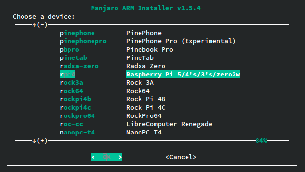

Question: Does Manjaro ARM installer support Raspberry Pi-5? The script did its work but the boot partition on the SD card is empty other than just the cmdline.txt and config.txt files. When i try to boot, RPI tells me that the OS on the sd card is not compatible with RPI-5. When i put in “os_check=0” it still doesn’t boot. I do believe it wouldn’t boot with an empty boot partition. Something is wrong here.
Yes - I have done it many times.
Did you select the rpi4 profile in the device selection screen?
Screenshot

It is Debian that i am running the script within. I selected the correct profile. I will try restarting that service. But why do we do it?

I am on aarch64. I think the problem was that the sd card was full and partitions were mounted from it.
That is a valid reason for failing.
