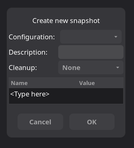

Thanks for the suggestion, I’ve already read through the Arch “Snapper” wiki Arch Snapper. I’m still not clear what information I’m supposed to put into the “Snapper GUI” to create new and separate snapshot configurations for @root and @home under Manjaro. I don’t want to enter the wrong information and ruin a days worth of tedious setup I’ve already done. I assume each sub-volume needs a separate snapshot configuration.
Screenshot From 2025-05-30 12-32-07
I only started using btrfs recently, so this is based on limited experience. The dialog you show is for creating a snapshot for an existing config, so you’ll need to create a config first. Since you can’t use btrfs-assistant I guess you should look at creating the config from the command line as described in the wiki you mention; you’ll use a command like
snapper -c config create-config /path/to/subvolume
You’ll replace the word config with a config name (.e.g. root or home), for instance
snapper -c root create-config /
will create a config file called root for the root partition, which would then be available in the Configuration combobox.
Once you create the config, I’d suggest looking at the created file in /etc/snapper/configs (it will have the name you used (e.g. root or home)) to get an idea of what can be configured.
