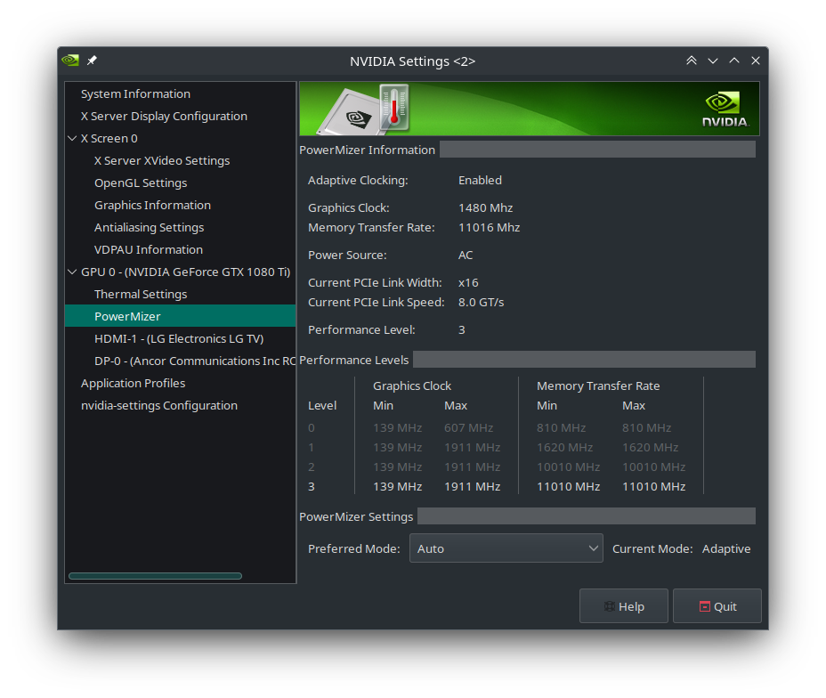

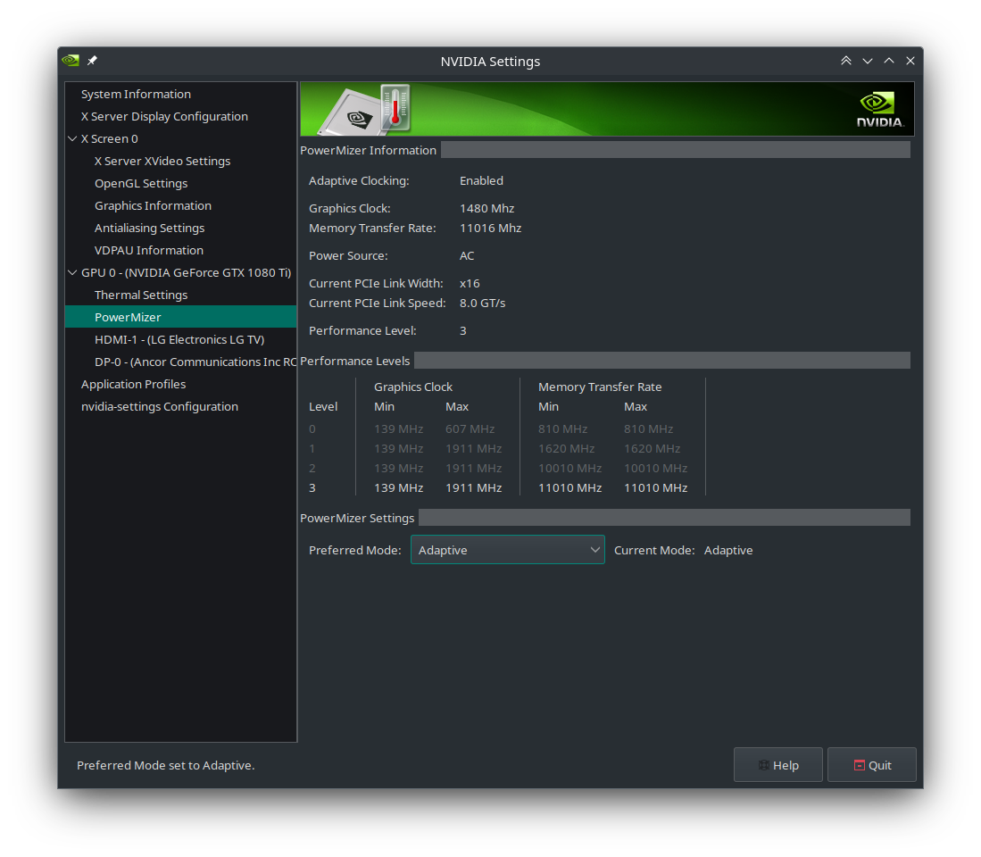

I am using a desktop PC with an Nvidia 1080Ti. Since I switched to Manjaro from Windows… I noticed that the GPU fan is slightly louder than what it should be normally. After some investigation and checking the arch wiki, I found this in the nvidia settings.
It seems that the nvidia clock is stuck at the highest setting, if I understand correctly… since level 3 is highlighted. However I’m not sure how to get it to change its level based on the amount of load. Is this possible?

I tried the preferred mode to auto from adaptive. However, it doesn’t seem to be getting set, even after restarting the computer. I feel like there might be something else I need to do? As you can see in the screenshot, the current mode is still adaptive.
