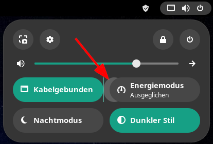

Another thing I noticed after the update is a display error in the GNOME shutdown menu top right.
GNOME48
I’ve selectively enabled/disabled all the pre-installed GNOME extensions. When I disable the “User Themes” extension, the strange button/glitch seems to disappear.
This is a theming issue, due to the Custom Accent Colors extension which is now deprecated and removed from the repositories.
It’s mentioned here.
And that seems a fair workaround. :wink:

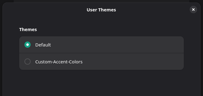

Nevertheless, if I check the settings for the ‘User Themes’ extension, it still shows an entry for ‘Custom Accent Colors’ (which I’ve change to ‘Default’ even though the extension is disabled atm)
gnome-extension_user-themes

Switching to User Themes Default rather than Custom-Accent-Colors probably helped in this case. If the extension was disabled, having it still selected in the GUI might have been contributing.
