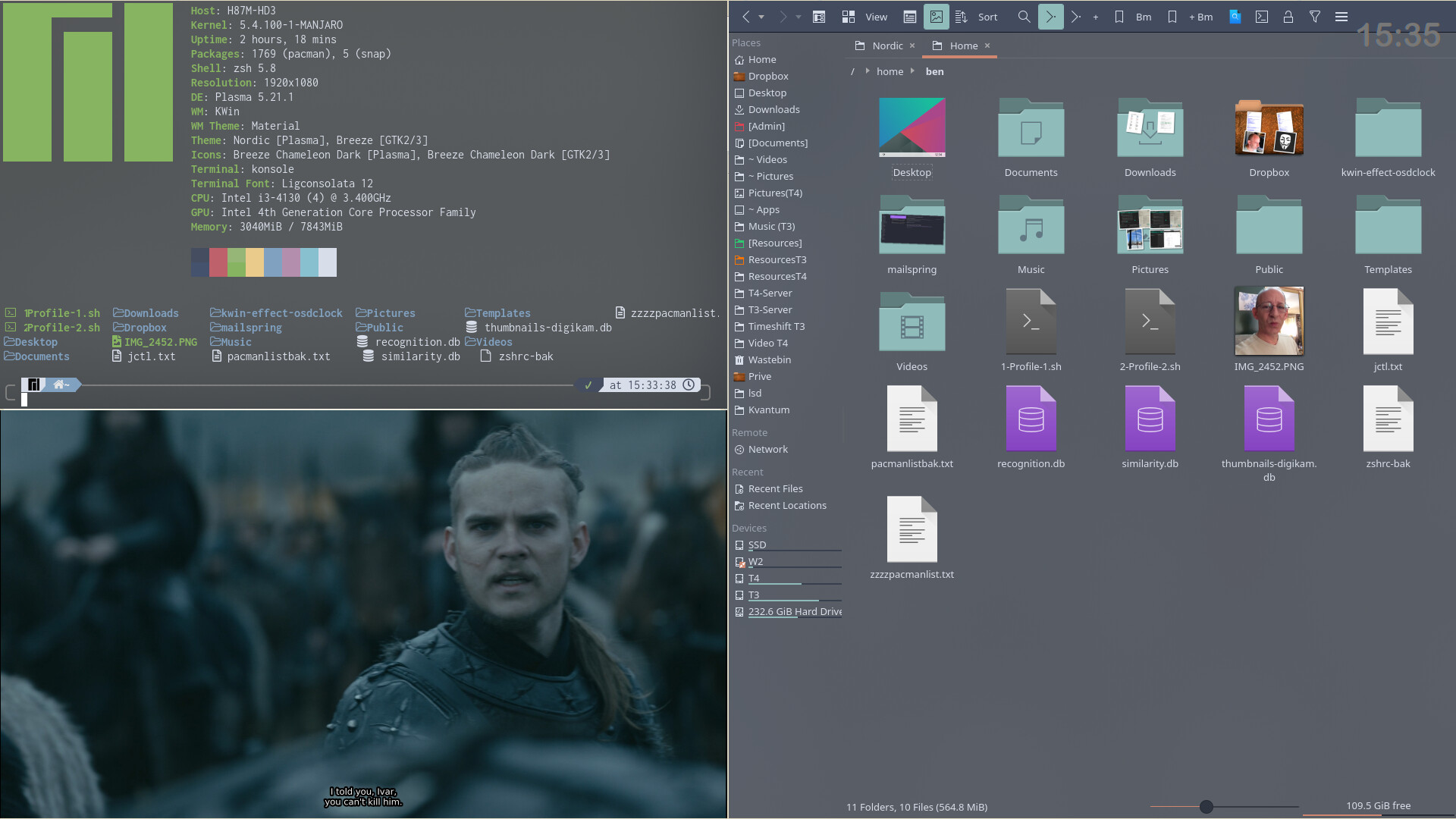

Finally done again - built a new Latte and tidied up some profiles… docks hide from windows (always in tiling mode) installed Kvantum and pulled in the configs from timeshifts.
Here it is in ‘cool’ mode with ‘inactive blur’ winter wallpapers.
