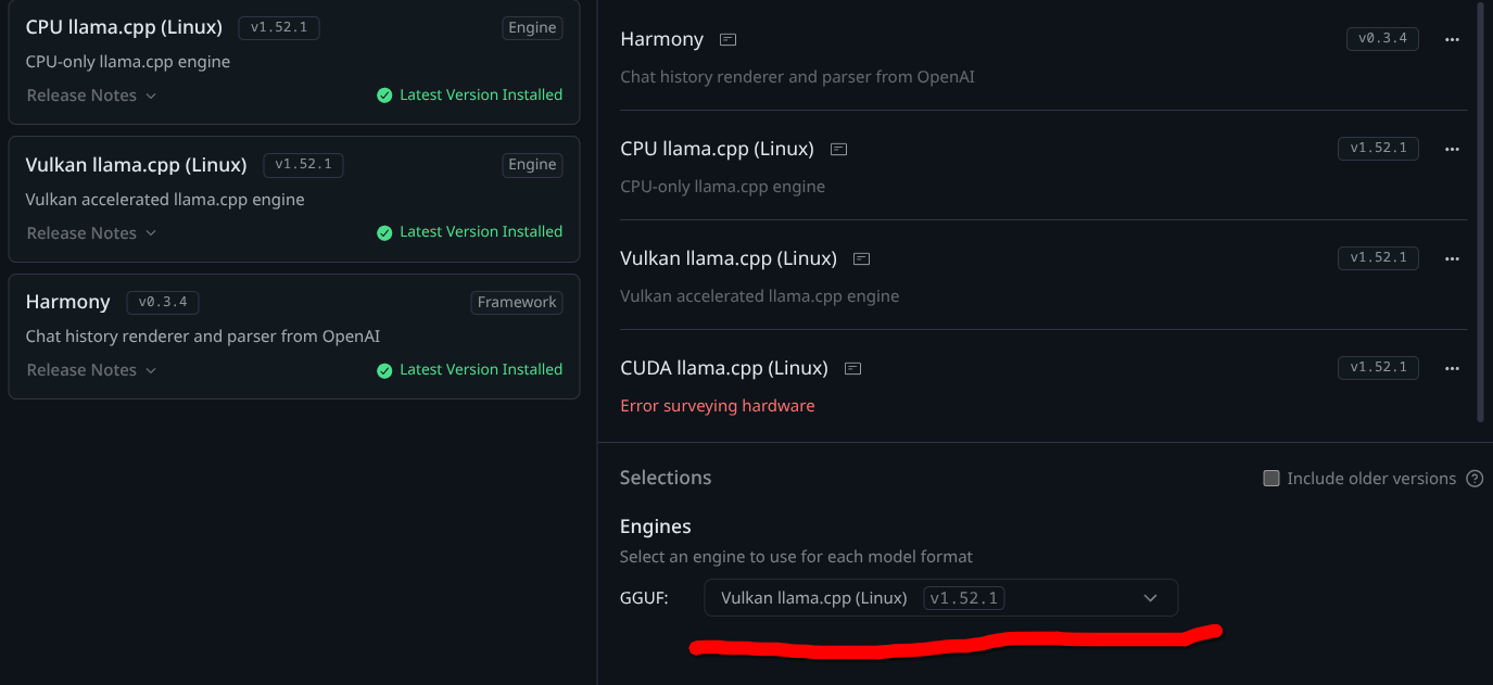

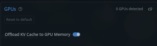

I recently moved from an AMD Radeon RX 6750 XT 12GB to an AMD Radeon RX 9060XT 16GB so I could enjoy local LLMs. This same GPU worked just fine in LM Studio when I tested on a live USB in another motherboard and games seem to be running well enough but because its not detected by the settings manager I cant use LM Studio :frowning:
I feel like this is related to some dumb kernel parameters I had to do at some point, but I cant figure what it might be.

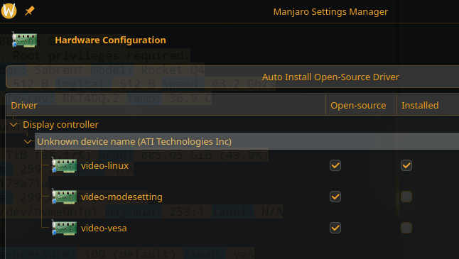

Whether LM Studio or whatever works properly doesn’t relate to Manjaro’s setting manager. Although the settings manager shows “Unknown device name” your graphics stack seems to work, and that means the discrete GPU (since there is no 2nd GPU around - this CPU has no iGPU) plus the required drivers. It’s all listed in the inxi output.
This means you have to investigate LM Studio itself - what does it need to detect a GPU - perhaps something like ROCm since it’s an AMD GPU. Where does the LM Studio come from - is it in the Manjaro/Arch repository (notice the AUR isn’t part of the Arch distro) or rather from somewhere else?
You can also quickly install the ollama-rocm package to see whether this runs on your GPU.
It’s an AUR package. Thread moved accordingly. :wink:
It’s also available as an .AppImage: https://installers.lmstudio.ai/linux/x64/0.3.30-1/LM-Studio-0.3.30-1-x64.AppImage …

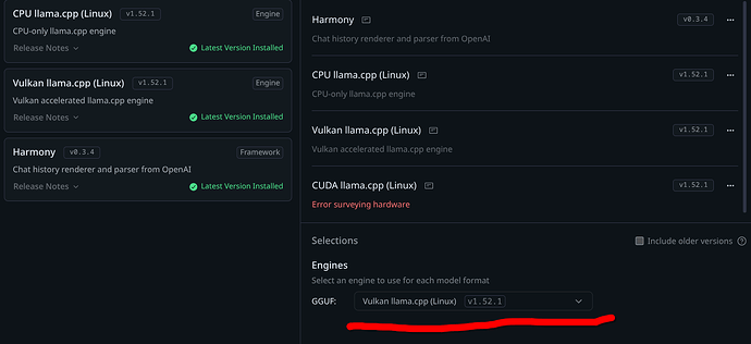

OMG clearly I was working on this too late at night. I had the wrong runtime loaded so it would not detect the GPU because the runtime did not support it!
