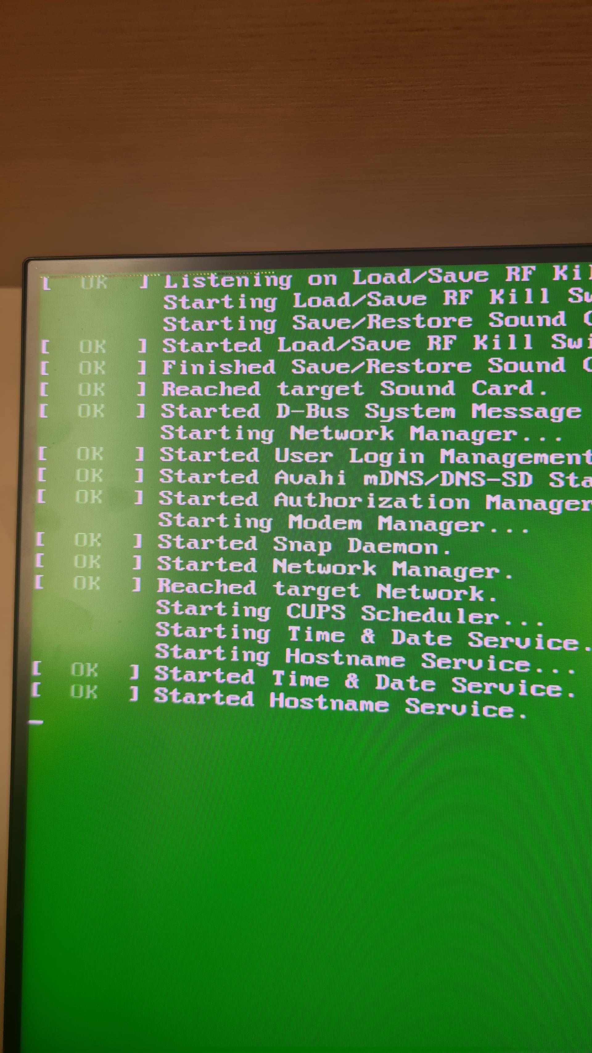

It freezes here with this artifact in the top, the screen is green, but the colors gets normal if I swap the monitor. Tried booting with the second monitor only and didn’t work

By doing “acpi=off” it went farther in the process, stopped here but it’s not frozen. I can access tty now, checked lightdm (systemctl status lightdm) and it’s active.

After that I’ll swap back the gpu and hope for the best.
Thank you a lot for helping me
This strategy worked. Used an older card do install the os, upgrade the kernel to 6.4, swaped back the card, it booted normally
