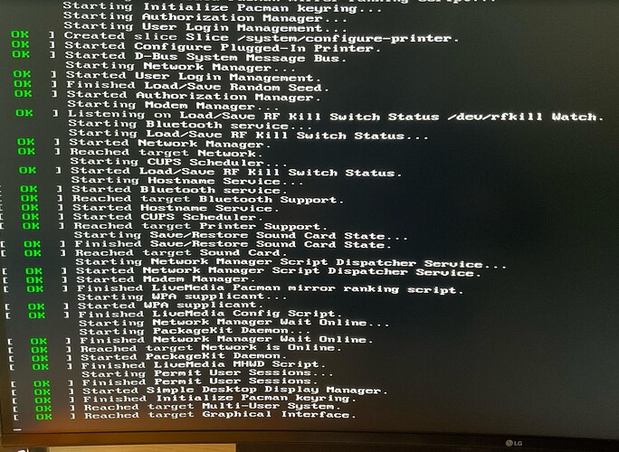

I tried with the cable ethernet, and after 2-3 mins it passes the keyring step.
but, as you can see in the screenshot, it goes to “Reached target Graphical Interface.” and it stays there!
Nothing after that.
I waited 10-15 mins, nothing happens.
