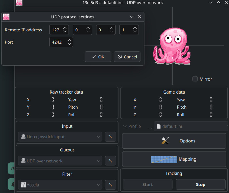

Note for some Linux native games that support OpenTrack and not LinuxTrack natively, you can use a Joystick bridge form LinuxTrack.
Run the Linuxtrack server:
Make sure it is pointed at 127.0.0.1:
