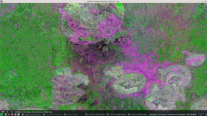

[jfl@jfl-opi5plus ~]$ mpv '/run/media/jfl/writable/home/jfl/Videos/jellyfish-120-mbps-4k-uhd-hevc-10bit.mkv'
● Video  --vid=1  (hevc 3840x2160 29.97 fps) [default]
Using hardware decoding (v4l2request).
VO: [gpu] 3840x2160 drm_prime[nv12]
V: 00:00:29 / 00:00:30 (100%) Dropped: 6
Exiting... (End of file)
video output is distorted color.
I think this is mistake somewhere in my PKGBUILD. I will look.

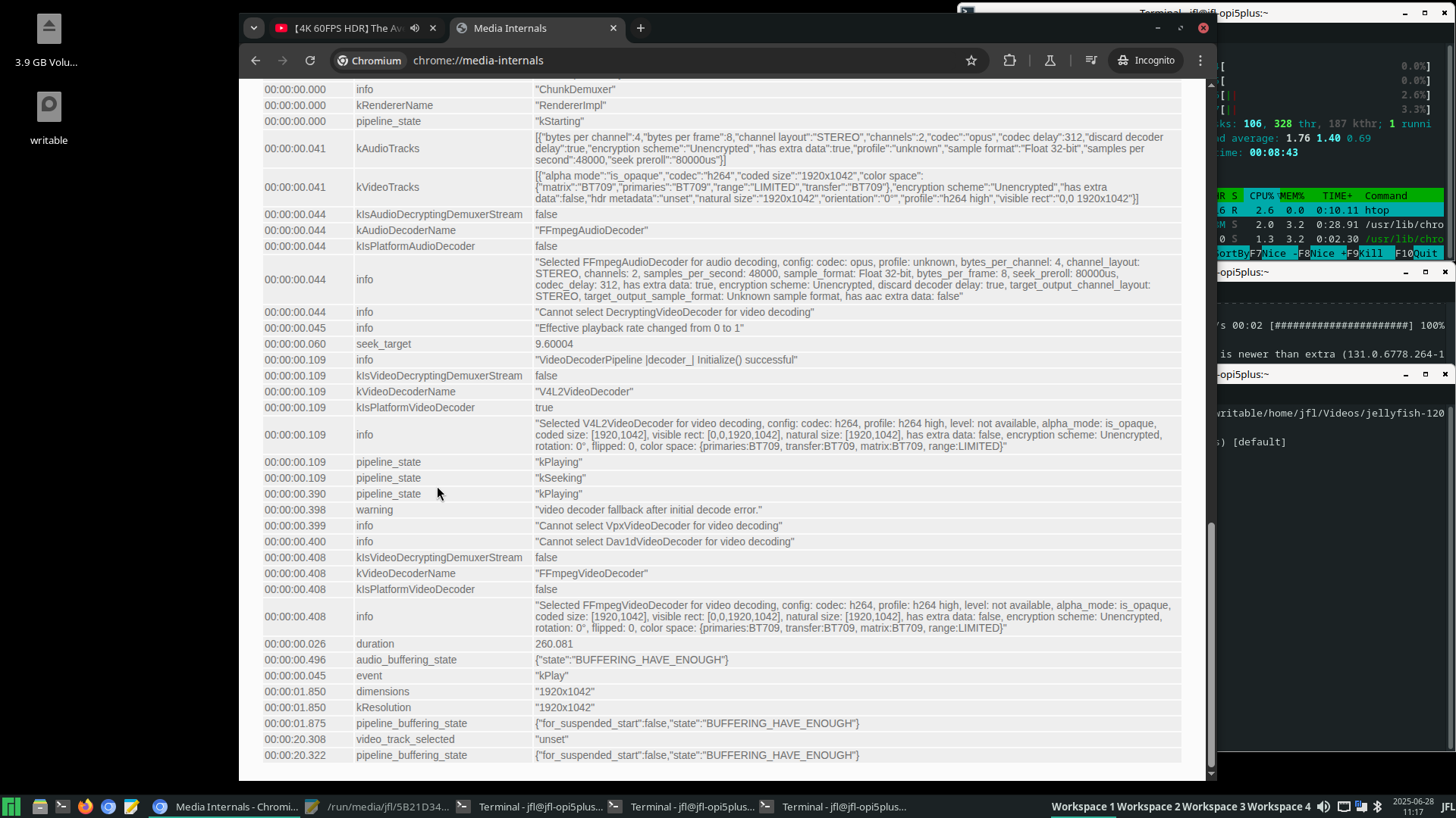

Both linux-6.15.3-1 and linux-6.15.4-1 mpv output distorted video output with “jellyfish-120-mbps-4k-uhd-hevc-10bit.mkv”. So NO difference
But there one interesting issue with the new linux-6.15.4-1. Now Chromium_v137 no longer support/select v4l2request when streaming h264 Youtube videos meaning loss vpu hardware acceleration on h264 video on Chromium.
Downgrade to linux-6.15.3-1 and Chromium_v137 support vpu hardware acceleration with h264 video. For now will stick with linux-6.15.3-1.
00:00:00.245 kVideoDecoderName V4L2VideoDecoder
00:00:00.245 kIsPlatformVideoDecoder true
00:00:00.245 info Selected V4L2VideoDecoder for video decoding, config: codec: h264, profile: h264 high, level: not available, alpha_mode: is_opaque, coded size: [1920,1080], visible rect: [0,0,1920,1080], natural size: [1920,1080], has extra data: false, encryption scheme: Unencrypted, rotation: 0°, flipped: 0, color space: {primaries:BT709, transfer:BT709, matrix:BT709, range:LIMITED}

Same results. HEVC video “Videos/jellyfish-120-mbps-4k-uhd-hevc-10bit.mkv” on mpv still distorted video output
Chromium_v137 no video hardware acceleration . Chromium tried to select “V4L2VideoDecoder” but resulted in error and then use “FFmpegVideoDecoder”.

mpv ‘jellyfish-120-mbps-4k-uhd-hevc-10bit.mkv’ will result in distorted colour/video output just like linux-6.15.4-2.
Chromium_v137 on MiniArch-kernel-6.15.4-1 has vpu hardware acceleration, video-decoder uses
00:00:00.140 kVideoDecoderName “V4L2VideoDecoder”
