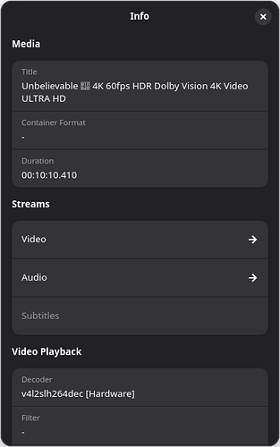

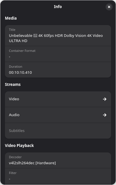

Edit: Update on Clapper Media Player with gstreamer-1.26.3 now can stream youtube 1080p/60fps videos and also play local 1080/60 hevc video.
mpv vpu hardware acceleration can support 4K/30 video
